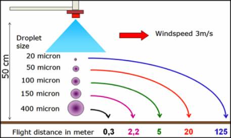

Yes, we are working on a few prototypes. running my nozzle next to what I currently have installed on my plane right now, there is a great deal of difference. Its a tip that I believe will reduce physical drift from spray planes. running some ground tests, nothing super scientific about it really, just putting my nozzle and the other nozzle side by side and pressuring up the system you can see a dramatic difference. Thats placing them in a 90 degree crosswind, not a fan or anything like that, just outside in real world conditions that we would fly in.
the reason I was looking for the psi and speed was to be able to run some actual string tests out of the plane, plane moving 150MPH ground speed with droplet moving 150 mph opposite direction, to have the droplet fall with less forces acting on it vs. being subjected to so much wind shear. As the process is now, its like throwing a tomato against a wall. your spectrum of droplets are large to fine and everything in-between. And these nozzles we are using now have been through rigorous testing by the manufacturer and they do have a data sheet on them, but I am simply trying to build something better.
Nothing new about this picture that you don't already know, just a glimpse of what we are dealing with. This is only at 50cm boom height. We are generally closer to 8-10feet above the crop canopy. Moving on average of 150MPH ground speed. For herbicide applications I want to be able to 'draw a line' with my airplane. A larger, more consistent droplet spectrum is the way to do this in my opinion, but we have to find a sweet spot between the physics of all of it and the biology of the plant and the mode of action of the chemical. In reality, it would be much easier just to keep doing what I am doing and go spray, but I think I am onto something with my design. Thanks for any help or input you may have
