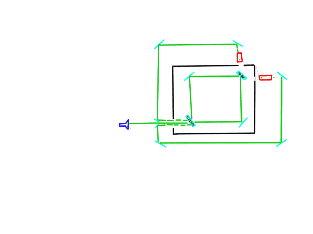

Let's take a Mach-Zender interferometer experiment as an example. In the picture below, I have sketched it (sorry for the bad sketch), where the blue lines are the mirrors (the ones with black inside are half splitters), the red boxes are the detectors, the green lines are the paths (possible paths) of the particle, the blue is the source, and the black is the parameter of the apparatus. As far as I know, the particle is lost at the detectors in order to observe them. My questions are as follow: is the loss of the particle inevitable? or is it a matter of how the detector is built? If the former, then I don't have any other questions. If the latter, then will using it again give interesting results? or will it just be as if we used another particle?
This is an example of what I was asking about. Hope this makes it clearer.
By the way, the paths outside the parameter are just my vision on how we can use the particle again if it was not lost.
Typically photons are measured by destroying them, while matter particles are still around afterwards - they might be in a different state, however. There are a few exceptions, and more complex setups, but that's the general trend.
Your setup isn't doing anything special here, it just makes the experiment (before detecting the photon) more complex.
