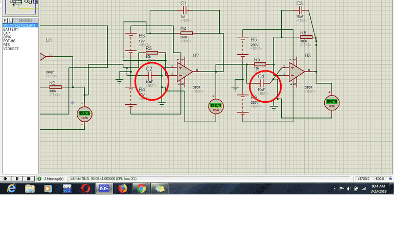

But, I simulated in Proteus. At the third stage, it's taking more voltage up to 230V. I am uploading the circuit with all the improvements made. please check.
Can you post a better image? I cannot read the circuit values or pin numbers.
Can you zoom in and make two screen shots (left and right)?

OK, I have done two parts and I am uploading. Please refer the third stage, where it's taking 230V and displaying 228V. Here, the question is op-amp taking 230V and displaying the output. Does it make sense?

The input V1 on your circuit is 10mV not 0.1mV
10mV * 27000 = 270V The power supply is 230V so the output of stage 3 will saturate at about 230V.
This circuit would not work if you built it. The maximum power supply voltage for the OP07 is +/- 18V. If you used 230V it will fail. It would also be dangerous.
I do not understand why you have these two capacitors...

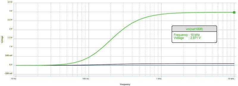

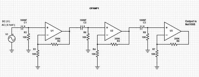

Here is my version of the circuit. My version amplifies AC only. If your source V1 is DC you need a different circuit.
I have not shown the power supply.
1) Input voltage: 0.1mV AC
2) Output voltage: 2.7V AC
3)Total gain required:2.7/(0.1*10^-3)=27000
4) I am using three stages each of gain of 30
The gain of the first stage is set by R2 and R1. Stage 2 and 3 are the same.
Capacitor C1 and R3 form a "high pass" circuit. This has a "cut-off frequency" of about 160Hz. Same for C2,R6 and C3,R9. This blocks any DC offset.
If you need a different cut-off frequency you can change C1, C2 and C3.
See also http://sim.okawa-denshi.jp/en/CRtool.php
Here is the output from the simulator. It is the frequency response for the output of stage 3 (Net1008)..
The output (above the cut off frequency) is 2.9V
I used these capacitors to reduce the DC offset voltage.

Tq, for the work done. Cant, we use DC input voltage and get the voltage, since while doing practically we prefer DC voltage to AC voltage. Can Even we use 10mV of input to draw the gain? Give me a solution.
  • #33
If the source is DC you must make these changes to my circuit.
1) replace the capacitors with a wire link.
2) add a variable resistor to each op-amp to remove the DC offset voltage. See the date sheet for how to do this. The offset voltage for the OP07 can be 75uV so if you do not do this the output could be 2V even with 0V input. 75uV * 27000=2V.
You cannot have an input of 10mV and a gain of 27000 because the output voltage would be 10mV * 27000=270v. This is too high. If the input must be 10mV then you must reduce the gain. I have explained this already. The maximum recommended power supply you can use is 15V. If the power supply is 15V then the maximum output of stage 3 is 12V. The maximum overall gain is 12V/10mV=1200. So if the input V1 is 10mV the maximum overall gain possible is 1200. So the maximum gain per stage is 10.6. You could use 12*10*10.
