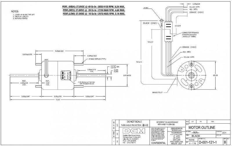

I am not sure exactly what sort of motors I have. I know they are DC but I have no clue about brushes, etc. I have a spec sheet which is attached if that helps at all.
Also, the only reason why I am considering this is I am wondering what will be the most energy conservative. I figured I would have less electrical consumption if I draw only 8.2 amps rather than multiple times that.
Any thoughts on this would be appreciated! I obviously don't know too much about this stuff.

It even looks like the motors have speed control on them already. Is that what the "High, Medium and Low" wires are for?
I believe the only difference between the High Medium and Low is they change the internal resistance so that the amperage is different.
