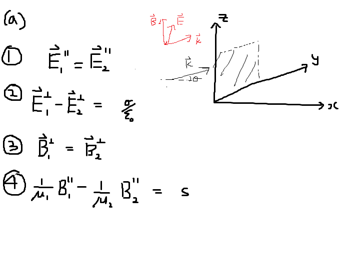

An EM wave is incident normally on a surface which absorbs all the electric field. Using maxwell equations, determine B-field on the other side.
If all the E-field is absorbed, won't ET and Er = 0? Then none of these boundary conditions make any sense.
Boundary Conditions:
bumpp
bumpp
