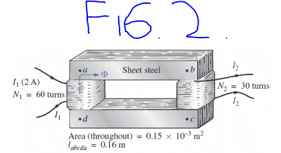

In our book, and lecture notes, the only magnetic series circuit we have is the attached fig. 2.
Surely to make the fig. 1 a series circuit, I would think that the magnet need a connection like the one in fig. 2 does:
But they aren't asking for that, so right from the start I'm probably wrong here. They ask me to draw any missing wire connections to connect the turns in a series connection. The only thing I can think of in regards to the turns is this:

It would appear that they want you to add a battery and wiring, connecting to the existing turns, in order to produce the given magnet polarity (N and S poles). Look up the Right Hand Rule for solenoid polarity, it'll apply to the individual sets of turns.

There are two circuits involved. One is the magnetic circuit comprising the flux, the other is the electrical circuit which runs through the wiring and produces the magnetic field.
You want to begin by creating the electrical circuit which will produce the required magnetic polarities. The right hand rule will guide you for choosing the correct current directions in the coils.

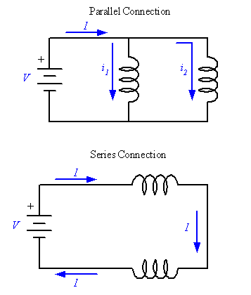

Ah. While that would work to produce the correct current directions in the individual coils, you've connected the coils in parallel with the battery, not in series. See below:
Note how in a series connection there is one continuous current that flows through both coils, while the parallel connection supports two separate currents, one for each coil.

Hmm, I overlooked that fact.
If I connect them like this, I pretty much get the first option in post #7.
My other option is to connect both points on the northern pole to +, and both points on the southern pole to -. Like this:
To be fair, I can't tell which of them would work, but if neither will work, I'm really lost hah.
Yes :approve:
That's correct!
That won't work because there is no closed electrical path (circuit) between the battery terminals; no current at all can flow.
You got it right in the first diagram. :smile:
