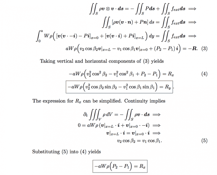

I think not.)In summary, an incompressible fluid of density ##\rho## flows steadily through a 2D infinite row of fixed shapes. The vertical distance between shapes is ##a## and the stations are defined as the space where velocity enters and exits. Velocity and pressure are constant along the stations and are given by ##v_1##, ##v_2##, ##p_1##, ##p_2##. The angle of the flow at station 1 is ##\beta_1## and at station 2 it is ##\beta_2##. The reactions ##R_x## and ##R_y## are necessary to keep one vane in place and can be calculated using
  • #36
Shoot, thanks! I'll fix this!
