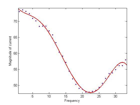

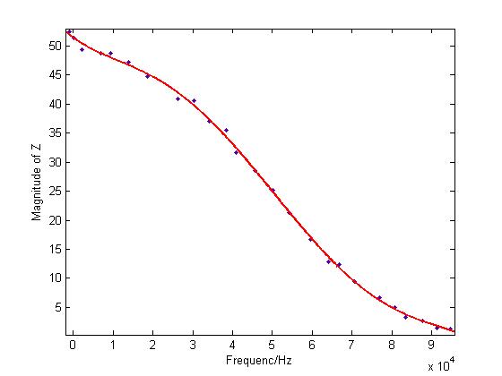

I want to model a system with a black box. my transfer function is conductivity and i just have Magnitude of impedance vs frequency in different temperature and magnitude of current vs frequency.
I would like how i get to it
Is that...
Output impedance Vs input frequency?
Output current Vs input frequency?
If that's all you have then you can't work out a transfer function ...
Output conductance Vs input conductance.
It seems the two graphs are of different signals. Is one the input, the other the output?
What is the input to the black box? What is the output?
Please provide a block diagram showing inputs, outputs and which signal is swept in frequency.

The output is conductivity vs time. i have some graphs of the system. 2graphs are attached above. the graphs include: Current vs time, magnitude of current vs frequency, current vs voltage, magnitude of impedance vs frequency and magnitude of current vs temperature.that's all. the graph of current vs time is dependent on temperature.

all graphs are related to a system. temperature, frequency, time are inputs of graphs
