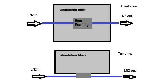

Here is a scheme depicting the setup.
Everything is in vacuum (minimizing radiative heat transfer) and some glass fiber epoxy supports were used to install the Aluminium block in the cryostat (minimizing conductive heat transfer). I only have a couple of temperature sensors on the Aluminium block.
The heat exchanger (attached to the Aluminium block) has an embedded circuit inside where pressurized Liquid Nitrogen (LN2) from a Dewar is flowing; it flows through some Swagelok stainless steel flexible tubes.
As I said, to get the instantaneous cooling power, I considered the heat removed from the Aluminium block by measuring ##dT/dt##, knowing its mass ##m## and evaluating ##c_p(T)## with the values given by NIST, here.

Please provide the dimensions of the block and the heat exchanger, including the geometry of the coolant channels.

Well, first of all, I just would like to know if the physical principle that I assumed (described in the first post) are correct: is the instantaneous cooling power is defined by ## dP = m c_p(T) \frac{dT}{dt} ##?
Secondly, I see a lot in literature (and in practical applications) that sometimes the cooling power is defined as, e.g., ##50##Watt @ ##77##K. How are these values defined?
This is correct if T represents the average temperature of the block. But, depending on the operating conditions, the temperature can vary substantially with location within the block. This is the reason I was asking those other questions.
Regards!
I'm not familiar with this standard. But you should be able to find somewhere in the literature a description of the experimental procedure required to implement this standardized measurement.
