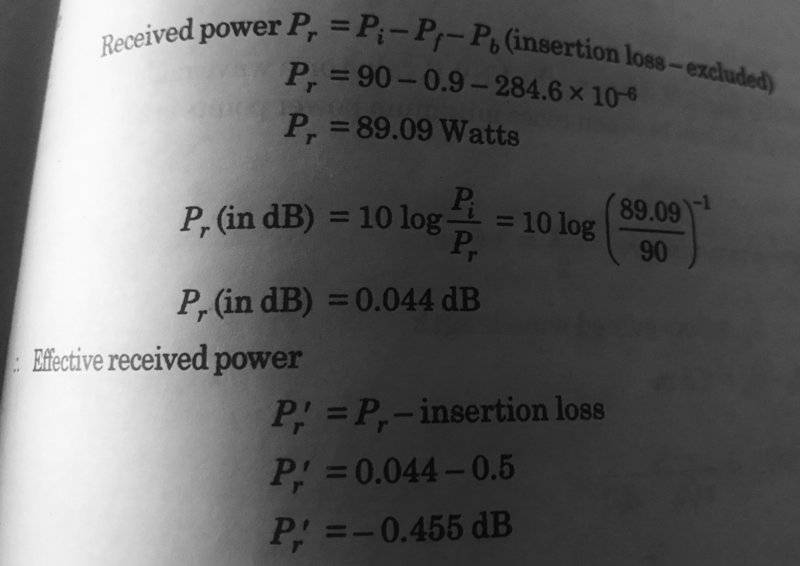

G’day.
I am here to clear my doubt about the dB scale, in general, and it’s use in calculating received power in a microwave cavity.
Given that I have arrived at received power (Pr in Watts) for a given input power (Pt), I understand that
10*log (Pt/Pr)
yields Pr in dB.
Now, say, the cavity’s a Directonal Coupler, which has an Insertion Loss (Il) of 0.5 dB. If I substract Il from Pr (in dB), and obtain a negaive number, that would violate basic principles as it implies Pr > Pt since log10 of a number less than 1 is negative.
Please do correct me.

That doesn't sound right. 10*log (Pt/Pr) is the ratio of Pt to Pr in dB, If Pt>Pr, it is a positive number, and if Pt<Pr, it is a negative number.

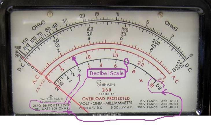

Power expressed in db is always a ratio and it assumes a reference power.
We usually state what that reference power is The number of db tells how much larger or smaller (compared to that reference) is the power you are describing.
So your expression gives, as Berkeman said, the ratio of transmitted to received powers - not an absolute number for either.
I know nothing of microwaves
I assume there's convenient reference power that's so commonplace people forget to state it.
I do know that in telephony there's a widely used reference power, one milliwatt, that's so commonplace it's on multimeter faces.
When selected to AC volts the bottom scale indicates power referenced to one milliwatt in 600 ohms, about 0.77 volts
In my day we suffixed our db reading with "m", eg dbm to indicate that one milliwatt reference power.
(purple marks mine - jh)

The ratio of Pt and Pr, which you have expressed in dB, is presumably the measured attenuation of the system under test, say L dB. If your system includes, a component, such as a directional coupler, which has 0.5dB attenuation, then the attenuation of the remainder of the system is L-0.5 dB. Yes, the remainder of the system has less attenuation.
On the other hand if you have calculated Pr, then you must have already included the directional coupler in the calculation, so subtracting it will not create negative attenuation.

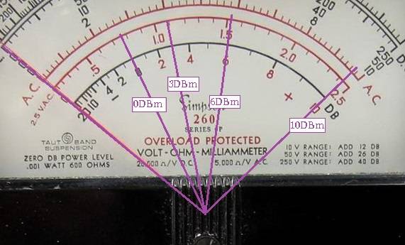

##P = \frac{V^2}{R}##
so 1 milliwatt into 600 ohms requires
##V = \sqrt{ {P}X{R}} = \sqrt {{0.001}X{600}} = \sqrt{0.6} = ~0.775 volts##
and 0db on Decibel scale is right underneath that many volts on red 2.5 VAC scale
(note the 2.5VAC scale is ever so slightly nonlinear - that's to handle nonlinearity of the diode rectifiers inside the meter)
3 db doubles power (actually 3.01db)
so ## P = Pref X 10^{\frac{dbm}{10}} ## and ## {Pref} = 1 milliwatt ##
so at 3dbm
10^0.3 = 1.995 , and
to make 1.995 mw in 600 ohms would require ## V = \sqrt{ {P}X{R}} = \sqrt {{0.001995}X{600}} = \sqrt{1.197 } = ~1.094 volts ##
which indeed is right above the 3db mark
at 6dbm
10^0.6 = 3.981 , and
to make 3.981 mw in 600 ohms would require ## V = \sqrt{ {P}X{R}} = \sqrt {{0.003981}X{600}} = \sqrt{2.389 } = ~ 1.545 volts ##
at 10 dbm
10^1 = 10 , and
to make 10 mw in 600 ohms would require ## V = \sqrt{ {P}X{R}} = \sqrt {{.01}X{600}} = \sqrt{6 } = ~ 2.449 volts ##
hmm.
at 6db I see 1.525 volts which would be 5.88 db not 6
either my purple line is just a smidge off, or the scale is.
I'd wager it's my hand drawn purple line.
old jim

Many thanks for all the responses. A special thanks to @jim hardy for the historical/analog, and especially his personal, perspective.
A big thanks to @berkeman & @tech99 for taking the bull by its horns.
Thanks also to @sophiecentaur and @poor mystic for chipping in.
jim hardy said:
I flogged this horse for benefit of OP because it seemed to me he wasn't thinking "ratio" and the analogue meter is my anchor to reality.
All help appreciated.
Before I proceed, I really must address @jim hardy about the source of this query:
jim hardy said:
Is this a real life experiment?
How precise are my "arrived at" numbers for Pt and Pr ?
This problem appears in a locally published and prescribed textbook for an undergraduate course in Microwave Engineering.
Next, a note on @tech99’s suggestion:
I follow your suggestion.
The second paragraph especially interests me. But I maintain my qualms about the subtraction.
Also, you prefer to term the ratio ‘Attenuation’ and not what I refer to it, i.e. ‘Pr’.
Perhaps that’s what’s contentious.
If we were to call it ‘Attenuation’, then I can clearly see now that the attenuation of the Circuit Under Test, with the Directional Coupler removed, would be L-0.5 dB. But, in terms of Pr, I cannot make peace with the given solution — see below the part of the solution to the question after all the mechanics of the DC are complete and all power values have been calculated.
In keen anticipation of your responses,
best regards,
wirefree

We only have a snip of the book, but it seems be mixing up decibel and absolute quantities. I am not at all happy about the calculation as shown or the units being used. For instance, power cannot be expressed in dB, only dBW, dBm etc. There must be a reference.
Thank you for your nice comments.
Likes wirefree, davenn and berkeman
i lack the vocabulary to decipher this one.
What the heck are "C" and "D" ?
What the heck are "Pf" and "Pb" ?
Where did that 284.6 X10^-6 come from ? I notice it's 55db down from 90 (Pi ?) and 55 is the sum of "C" and "D". Is that coincidence?
Is "Effective Received Power" Pr' defined someplace?
If -0.445 = ##10log\frac{P_r'}{90}##
then 10^-0.0445 = Pr' /90
and Pr' = 90 X 10^-.0445 = 90 X .90261 = 81.2 watts ?
I agree ... really odd
and particularly this part
@wirefree C and D are not even defined in the text you have given us
Likes jim hardy

It is a directional coupler so it is probably the coupling and the directivity
Likes wirefree and Averagesupernova

Christmas Greetings to All - whichever part of the world you are in. I hope it’s a good end to the year for everyone.
wirefree
@tech99 @jim hardy @davenn @f95toli @sophiecentaur
Thank you for sticking around.My effort here has been to not expose you to the inner workings of the Directional Coupler. Related to it are concepts such as Coupling (C) and Directivity (D). How they are calculated and what their magnitudes are in this particular question, I hoped, wouldn’t concern you as long as their units were mentioned.The relevant terms remain Px’s , units of which have been clearly mentioned.Warm regards,
wirefree
Likes jim hardy
  • #34
Well Thanks for the feedback and kind wishes - they are reciprocal
i only tried to address this query
but asked about D and C for fear i had missed something fundamental
i hope you're more confident with db now.
Myself, i was glad to see db is still on the Simpson 260 meter face.
It's the only piece of nostalgia i know that's "still made just like they used to."
old jim
