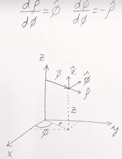

  1. I'm having a hard time trying to understand how come ∂r^/∂Φ = Φ^ ,∂Φ/∂Φ = -r^ -> these 2 are properties that lead to general formula.
  2. I've been thinking about it and I couldn't explain it. I understand every step of "how to get Divergence of a vector function in Cylindrical Coordinates" except for these formulas below.
A picture attached for visualization.

TheColector said:
Hi there
View attachment 226837 A picture attached for visualization.
3.
View attachment 226838 General formula
Thanks for any help.
If you apply the definition of derivative, these formulas will fall right out. For ##\frac {\partial \hat r} {\partial \theta}##, start with ##\hat r = (cos \theta, sin \theta)##.
