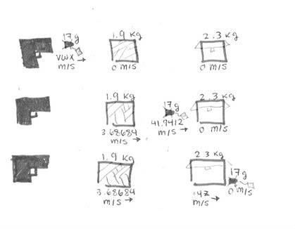

A 17 gram bullet is fired from a gun with an original velocity of vwx m/s. It collides with a 1.9 kg tupperware covered in camo duct tape, giving the tupperware a velocity of 3.68684 m/s. As the bullet approaches the second obstacle, an ammo can, it is moving 41.9412 m/s. It collides and passes through the ammo can, giving the can a velocity of .yz m/s, then the bullet drops dead as soon as it leaves the can, its velocity reduced to 0 m/s. If the ammo can has a mass of 2.3 kg and all air resistance and mass removed by collisions is neglected, determine the original velocity of the bullet and the velocity of the ammo can after the collision.

I know nothing about physics as to solve problems. I'm trying to solve a puzzle and need the above questions solved to complete the puzzle. Any and all help is appreciated.

The second problem is one about conservation of momentum. Momentum is equal to mass times velocity,
[tex]p = mv[/tex]
(why p? who knows, but that's common usage) and when we say it's conserved, we mean that the total momentum before a collision of all objects involved in the collision is the same as the total momentum after a collision of all those same objects. So if you have two objects, A and B,
[tex]p_{A(i)} + p_{B(i)} = p_{A(f)} + p_{B(f)}[/tex]
where a subscript A refers to momentum of object A, subscript B refers to momentum of object B, and (i) and (f) refer to initial (before the collision) and final (after the collision) respectively. In your second problem, there are two collisions, and you can do this separately for each collision.

The second question should still be doable, as long as you can do algebra... all you need to do is set up some equations and solve them. There's no need to take the derivative of anything for that, so no calculus involved. If you want to give it a try, we can point out any mistakes.
