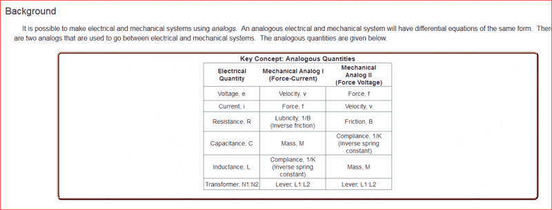

For a basic understanding there are some valid analogies ( although PF-EE seems to hate them) - but have you seen anything like THIS and http://www.dartmouth.edu/~sullivan/22files/System_analogy_all.pdf ... do not get hung up on not understanding - it usually just means you need to take one (or two) steps back and look at the fundamental elements.

If you were asked to write equation of motion for a spring-mass-damper system
where would you start?
That was an exercise we had to do in freshman EE
Your question is analogous to force on a spring vs force due to friction
From the first link by windadct (he beat me to it !)
http://lpsa.swarthmore.edu/Analogs/ElectricalMechanicalAnalogs.html
force-voltage analog was more intuitive for me
though force-current works equally well
