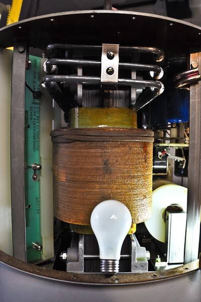

As for my power supply,
It is a 15,000 Watt X-Ray transformer. The above pic is with it removed from the oil. the full wave bridge is on the left side.

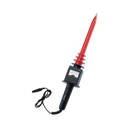

I then grabbed my High voltage probe,
Mine looks just like this,
And verified my output.

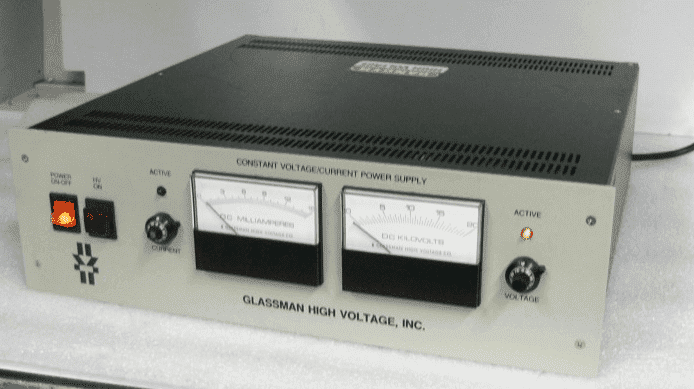

and for my EMP tests last night I used my Glassman,
I have much more consistent control over current and voltage.
