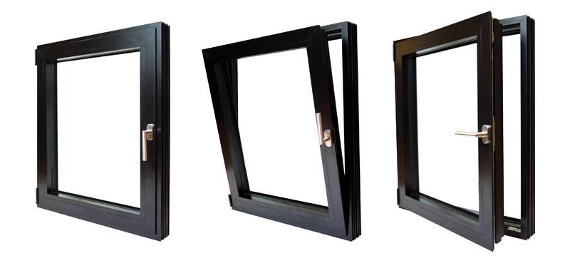

My window looks like this, and the thing is I was wondering if I opened the one on the right to the max would it make a difference from opening it to the one on the middle

I would most likely choose the second one, but would it make a difference if my window was half open or fully open? like does it make the room colder if I choose the fully open one? ( Please watch the picture for reference, also thanks for commenting I thought nobody would answer this)
In this case, it has to do with the open surface area and the direction of the air.
Generally, in the middle window, the volumetric flow will be less (if you have the same opening area with the third window), because the molecules of air will be scattered in a bigger extent and most of them will return outside the house.
Anyway, if you let the window open for much time, the room temperature will be equal to Tout. However, the faster way to reach Tout is the third window (this way of opening).
