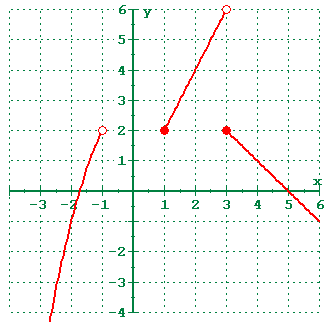

Just wondering how to write the domain of where a function similar to this is continuous:
using proper domain notation.

Do you mean continuous or connected?
Your 'function', if it's the set of red lines' is not connected.

Yes, but the set of points at which this particular function is continuous ("domain" is the wrong word) is the union of three intervals. Using interval notation to state that set is perfectly correct.
Since Shaybay92 said, in the original post, that interval notation was to be used in stating the answer, I have no idea what KrisOhn meant by saying " I'm pretty sure its accepted to use interval notation." Neither that nor his Wikipedia link to what an interval is contributes anything to the problem of determining what those intervals are.
Shaybay92, you should be able to see from the graph that this function is continuous on three intervals. The set can be written as the union of those three intervals:
[tex](-\infty, a]\cup [b, c)\cup [d, \infty)[/tex]
You should be able to see from the graph what a, b, c, and d are.

Assuming HOI has the correct interpretation of the question, and that an open circle means an open interval and a filled in circle means a closed endpoint
I think only the first interval is continuous.
Is the second interval not discontinuous at b and the third at d?
An interval cannot be continuous, a function can be continuous on (points in) an interval.
The function is not continuous at -1, since -1 is not even in the domain.
The function is continuous at 1, since the limit as x approaches 1 is the same as the right limit; there is no left limit because there are no domain points to the left of 1 (sloppy language, but consider small open balls around x=1).
The function is not continuous at 3, because left and right limits do not coincide.
So the desired set is [tex](-\infty,-1)\cup[1,3)\cup(3,\infty)[/tex].
This is the same as [tex]D\backslash\{3\}[/tex], where D is the domain of the function.
Yes some sloppy Sunday terminology all round I whit.
But collectively we got there in the end.
I think the last offering by Landau to be correct.
