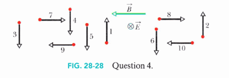

The figure shows crossed uniform electric and magnetic fields and, at a certain instant, the velocity vectors of the 10 charged particles listed in the table. (The vectors are not drawn to scale.) The speeds given in the table are either less than or greater than E/B (see Question 1). Which particles will move out of the page toward you after the instant shown in the figure? (Several choices may be correct.)
Right/Left Hand Rule (RHR) & (LHR)
Not sure what I'm missing because based on the RHR and LHR 1 and 2 are going out of the page, 3-6 are going into and 7-10 are 0, I think.
It said my answer was wrong when I just put 1&2.
Please help I only have one attempt left and I really don't understand. ;-;
Many of your answers are incorrect. It appears to me that you might be neglecting the force due to the electric field and also neglecting the fact that some of the particles have negative charge.
For example, can you explain in detail how you conclude that particle 1 will move out of page?

Isn't the magnetic field, B, the finger tips and the thumb the current or velocity vectors and the palm tells where the force is coming out of? And RHR is for positive charge and LHR is for negative charge?
So since the charge is positive you use the RHR and since the magnetic field is going left you point your right hand fingers to the left of the page and you point your thumb toward the top of the page and you get the force going out of the page?
Yes, that's right for the B field. But what about the force from the E field?

Yes. So, let's check your work for particle 1. What is the direction of the electric force? What is the direction of the magnetic force? And what is the direction of the net force?
The electric force goes into the page
The magnetic force goes to the left of the page.
The net force goes into the page?
No. Use the RHR.

In what direction did you point your fingers and in what direction did you point your thumb?
I pointed my fingers into the page and thumb to the top of the page.
Point your fingers in the direction of the B field.
Yes.

So its out of the page?
Yes, the magnetic force is out of the page. So, next you need to determine the direction of the net force.

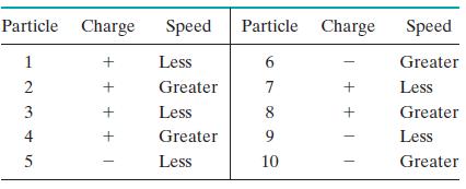

Would the electric force and the magnetic force cancel for the net force?
If the magnetic force happened to be stronger than the electric force, what would be the direction of the net force?
How are you going to decide which force is stronger for particle 1? Have you used all of the information in the table?

Is the strength of the force determined by the speed?
For one of the forces the force is related to the speed. For the other force it isn't.

So only 2 and 6 are going out of the page?
I agree that 2 and 6 have net force out of the page. But they aren't the only ones with net force out of the page.

Are 7-10 also included or is their magnetic force 0?
Right, the magnetic force is zero for 7-10. So, you only need to consider the electric force for these.

The electric force is into for all of them?
No. Don't forget to take account of the sign of the electric charge of the particle.

So 9 and 10 too?
Yes, 9 and 10 will have a net force out of the page.
So far, I think you have 2, 6, 9, and 10 out of the page. Any others out of the page?

Is 5 also included?
  • #32
Yes!
