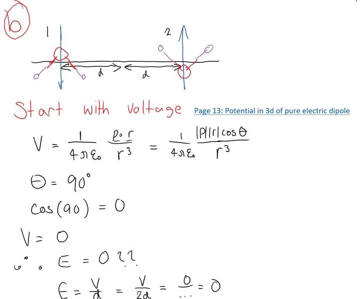

Hi Kuruman,
Thank you for answering Ivan's question!
I'm actually working on the same past paper (Well, a previous one, with identical parameters) and we've produced quite different results that I'd like to verify.
My answer for ## \vec p \cdot \vec r ## was 0, given the two vectors are perpendicular, which produced a bit fat 0 for V, which basically propagated throughout the next few questions.
I can see that Ivan's done some stuff, and it looks like good math to me, but I don't know why my working would be wrong.
Matthew Strasiotto said:
My answer for →p⋅→rp→⋅r→ \vec p \cdot \vec r was 0
That's because the dot product is not zero. You can see from my working that the r vector has an x and y component (the variables x and y respectively). The p vector has no x component but a y component of 6.2⋅10-31.
Please examine Ivan's working carefully. The y-component of the electric field ##\vec E## at the location of the dipole is the negative derivative of the electric potential ##V## with respect to ##y##. Your mistake is that you found the value of ##V## at a specific point, so naturally when you tried to take the derivative to find the electric field, you got zero. No surprise there because the derivative of a constant is always zero. To handle this, first you need to find a general expression for ##V##, then take the derivative to find a general expression for the electric field with ##y## as a variable and finally evaluate that expression at ##y=0##. That was Ivan's approach.
kuruman said:
Please examine Ivan's working carefully. Your mistake is that you found the value of ##V## at a specific point, so naturally when you tried to take the derivative to find the electric field, you got zero. To handle this, first you need to find a general expression for ##V##, then take the derivative to find a general expression for the electric field with ##y## as a variable and finally evaluate that expression at ##y=0##.
Ivans approach makes plenty of sense - I tried to cut corners and got my comeuppance :D
Thank you for your rigorous breakdown - I believe I have it now.
