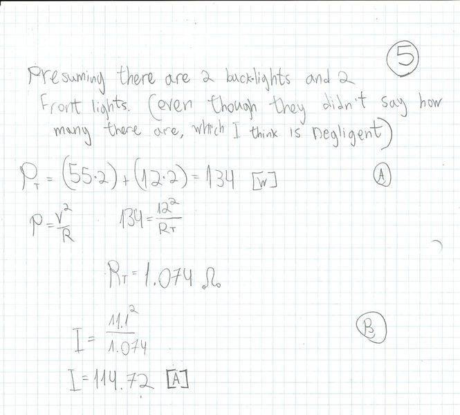

A voltage of a car battery is 12V, the current requires for movement is 200A. When we turn the lights on the voltage drops to 11.1V. The power of each backlight is 55 watt, the power of each front light is 12 watt.
A) Calculate the internal resistance of the battery.
B) What is the max current that the battery can supply?
I'm trying to understand first of all how can voltage DECREASE when you turn the battery on. Isn't the potential difference a constant thing between a certain + and a certain -?
I at any rate tried to solve it, but I have an inkling I'm not quite there.
Hi FP,
I see you're taking electronics to the next level.
Let's see if I can explain this.
Before I start, however, are you sure about the numbers in the problem?
It seem rather odd that a back light would dissipate so much more power than a front light.
Perhaps the numbers should be reversed? That would be close to real life.
That is 55 W for each front light, and 12 W for each back light.
Until now we took batteries for granted and said they would give a constant voltage.
However, in reality that only holds true when the current is sufficiently small.
When the current is significant, the voltage of the battery drops (from 12 V to 11.1 V in your problem, so that's 0.9 V).
This behavior of batteries is modeled by saying they have a so called internal resistance.
So it's just as if we have a perfect battery that really delivers 12 V, that is in series with an internal resistor, which is then connected to the lights.
If you can find the current flowing, you can use Ohm's law (V = I x R) to determine the internal resistance.
Note that there is however a 2nd real-life issue.
The lights are specified with watts instead of ohms.
The reason is that their resistance isn't quite constant, so they are modeled as if the power they dissipate is constant, which is closer to what really happens.
So the lights get 11.1 V and dissipate 134 W.
With the power formula (P = V x I) you can calculate the current that will flow (without the engine), and use that to find the internal resistance (as I wrote earlier).

That seems real simple. I just used 12 instead of 11.1, not sure what's the difference. I think I understand now with the earlier comment.
Can you find the internal resistance then?
Because in your scan you calculated the total resistance instead of the internal resistance.
The next step would be the second part of your problem, which is the max current the battery can supply.

I'm not sure what you did here?
You seem to have combined the voltage across the internal resistor with the power dissipated in the lights.
I've attached this image to try to clear it up:
You can combine the voltage across the lights (11.1 V) with the power dissipated in the lights (134 W) to yield a current I through the lights.
This same current I flows through the internal resistor which has a voltage of 0.9 V across, which can yield the resistance of the internal resistor.

I was trying to use the power formula with V and R, but I forgot to square V.
Seems simple enough. I'm off the scanner so I'll just type it here.
So,
P = IV
134 = I x 11.1
134/11.1 = I
I = 12.072 [A]
Speaking of "power dissipation", is it directly related to energy conversion efficiency? Let's say you have to invest 1100 [W] to operate something that requires 1000 [W]. 100 is power dissipation, yes?
R = 0.9/12.072 ohms
So the voltage that drops during the turning-on of the car, that is to say delta V, is in fact the potential difference in the internal resistance?

Yep. That's it :)

That leaves the second part of your problem, what the maximum current is that the battery can supply.
This would be the case if the lights are switched off and the battery is short circuited.
Since you now know the internal resistance you should now be able to calculate the maximum current...

Wait actually... you've said this is with the lights being turned off and the battery short circuit...so I don't have P... I do have V when the thing is off, so
Imax = V/R
Imax = 12 OVER 0.9/12.072
Is that right?
Femme_physics said:
So when we're asked for "maximum" current we treat a circuit as though it's turned off?
We're asked for "the maximum current that the battery can supply".
So we remove the battery from the circuit and prod it to see how much current it will give.
It will give it's maximum current when it is short circuited (and then probably explode or burn out :devil:).

As you already remarked, you don't have a P that is dissipated in the lights. :)
Femme_physics said:
Imax = V/R
Is that right?
Yep! :)
Careful how you calculate that though, you need to keep your parentheses straight (or "round" I guess :smile:).

What are your final, calculated values for internal resistance and maximum current?
Internal Resistance = 74.44 milliohms
Imax = 160.96 [A]

Thank you so much for helping me out with this.
