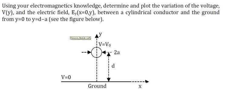

See figure attached.
Originally I have solved this problem using Gauss's law by defining a gaussian surface in the form of a cylinder around the floating cylinder to get the electric field distribution underneath the cylinder to ground.
The result I obtained was,
[tex]V(y) = \frac{Q_{pul}}{4 \pi \epsilon_{0}}\left( \frac{ln(d-y)}{d} \right)[/tex]
but since we aren't told what Qpul is we cannot plot the variation of the voltage.
My professor suggested I try solving this problem using image theory and laplaces equation in cylindrical coordinates in order to avoid Qpul.
Can someone explain to me how this done?
Thanks again!
Thanks again![/QUOTE
Problem with Gaussian surface is, the charge is not uniformly distributed so you can't take advantage of symmetries.
The image is a similar conductor of opposite sign a distance d below the ground.
This is a real bear of a problem. What you want is the capacitance between the cylinder and the conducting plane, i.e. the capacitance between the cylinder and its image.
Do you use Jackson?
