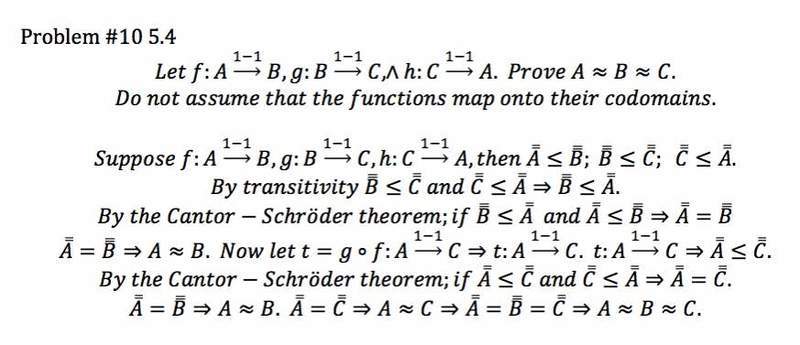

Suppose there exist three functions:
f:A[tex]\stackrel{1-1}{\rightarrow}[/tex]B
g:B[tex]\stackrel{1-1}{\rightarrow}[/tex]C
h:C[tex]\stackrel{1-1}{\rightarrow}[/tex]A
Prove A[tex]\approx[/tex]B[tex]\approx[/tex]C
Do not assume the functions map onto their codomains.
I took a screenshot of my work and have attached it to the post. My question is concerning my last step, setting t=g[tex]\circ[/tex]f. Mathematically speaking I don't know if it is legal, however I don't see why I would not be able to do such an operation. Thanks in advance for the assistance.

That's fine. But there's also no reason you can't just use transitivity to show A<=C just like you did for B without using the composition.
I didn't even think about the transitivity of A and C until you pointed it out! I always over complicate these things. I think I will employ that method tomorrow should this problem appear on my exam. Thanks for your help.
