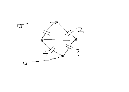

Find equivalent capacitance between terminals
C_eq = C_1 + C_2 for parallel
C_eq = 1/((1/C_1) + (1/C_2))
I can't tell what's in parallel and what's in series. That conductor in the center is throwing me off.
Any help por favor?
You guys might not be able to see the image because it's pending approval. I uploaded it to imageshack:
http://img377.imageshack.us/img377/5690/53235366dg9.png

Hi!
Then pluck it out! :mad:
Hint: Draw it as a figure-of-eight …
does that have the same potentials? :wink:
