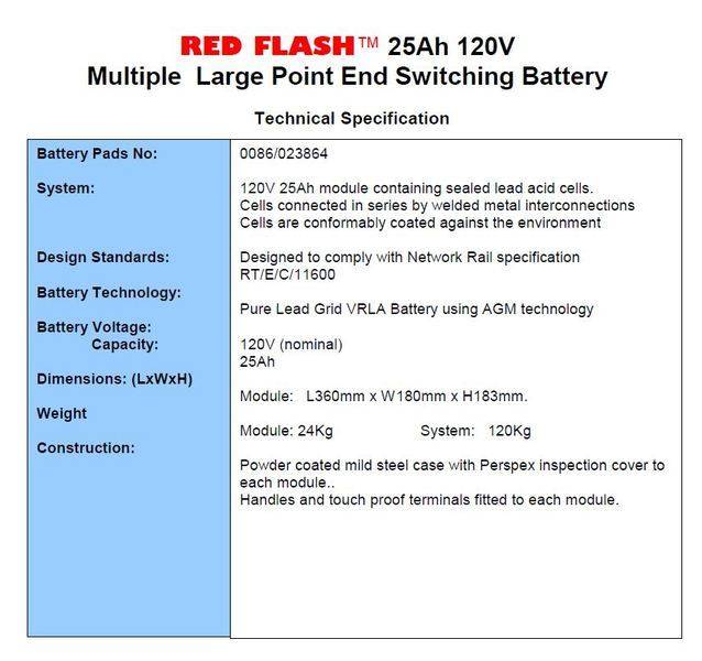

Hi..
I am working as a signalling engineer in Railways. This weekend i am going to give a presentation on super capacitors and their use in railway systems. Most importantly i am going to show how we can replace batteries with super capacitors (EDLC). The problem i am facing is i don't have any practical experience with capacitors and don't know how to show a relation between a battery and a corresponding equivalent capacitor. The type of battery we are using for driving the point machines (Google search "point machine railways") is of the type (Please refer to the attached image).
Now what i need is an equivalent type of super capacitor which will be able to drive the same type of point machine. Guys if anyone of you who has an experience in this field please help me in finding the answer of the following questions:
1. What will be the equivalent value of the super capacitor for the above mentioned battery?
2. What will be the dimensions of such a super capacitor?
3. How much will it weigh?
4. Model or company's product which i will be able to use (links are most welcomed).
All suggestions are welcome.

Supercaps and batteries are pretty different. Its kind of insane to suggest flat out replacing one for the other without a lot of consideration for your requirements. Do you really need 25 A-hours? That is asking a huge amount from capacitors. Supercaps have a much lower energy density with a much high power density, but if you still need that same amount of total energy, you'll need 10x as much space with super caps. Or more.
After I read the link I decided too that it is impractical to do in this case. That great big spark that you get when you short the terminals looks impressive but a capacitor is very seldom a good replacement for a battery.
25 AH = 90,000 coulombs
if you're wanting say 12 volt drop (10%) , and C=Q/V that's 7500 farads ?
China is making some 7500 farad caps for locomotives...

120 V and 25 Ah is 3000 Wh. You'll need 20 of those
http://www.maxwell.com/products/ultracapacitors/docs/125vmodule_ds_1014696-7.pdf
wich weigh 61 kg each, and store 140 Watt-hour and contain 48 beercan sized 3000 F 2.7 V capacitors in series, as well as a voltage convertor to maintain 125 V even when the capacitors discharge, as well as cooling fans.
Likes 1 person
willem2 said:
120 V and 25 Ah is 3000 Wh. You'll need 20 of those (these? old jim )
hmmm 20 X 61kg = somewhat over a long ton...
they're ~75 farads so it'd take a hundred of them to avoid the voltage converter
i'm starting to appreciate the humble lead-acid battery with 10X the wh/kg.

We all took your battery specification as a starting point. All it gave us was the battery capacity.
In addition to the switch specifics,
How many times do you want the point switch to cycle before recharge is necessary?
How long must it be able to sit unpowered and still be able to move the switch ?
What happens if the switch is covered with mud or snow - does it take more power to cycle?
How many point switches does the battery serve?
Is there any other load on it , maybe communications ?
Maybe that rail spec RT/E/C/11600 is enlightening ... we don't know.
Tabulate your energy needs. That's the stating point.

Re point 2: i'd guess the reason for having a battery in the first place is so the switch will move even if local power is lost for a while. And the system can alert somebody to come investigate the power loss.
Your switch link doesn't say what is operating current, just it's a DC motor.
So the question becomes: why was the battery sized 25 amp-hours ?
Does it need to supply that much charge? Or is that how big the battery needs to be to delver a brief ten or twenty amp burst ?
If the latter you could take advantage of the capacitor's high current capability and use fewer farads.
If the former our numbers were about right.
Remember that during a power failure the point switch has to rely on the battery long enough for some maintenance guy to come out and restore the local power.
So find out how long that Maxwell unit can sit unpowered before its own inverter and fans deplete its stored energy.Lastly - the Signalling Solutions link says "Fitted with two externally controlled heaters the machines can operate efficiently in a wide range of ambient temperatures. " Does the battery have to power those heaters ?
So - your first step is to define your power and energy needs, both peak power and total watt-seconds .

Are you familiar with basic electrical units
the Coulomb , Ampere , Joule, Volt, Watt , Farad ?
http://hyperphysics.phy-astr.gsu.edu/hbase/electric/elecur.htmlFarad = Coulombs per volt http://hyperphysics.phy-astr.gsu.edu/hbase/electric/pplate.html1100 VA at 110 volts is only 10 amps, which for 30 seconds is 3000 coulombs
if you size for 10% drop , C = Q/[itex]\Delta[/itex]V = 3000/11 = 272 farads
which sounds like about four of Willems units from post #7 .
That'd run a 110 VDC switch well, like your HW1000 and HW2000 in the spec sheet - the supercap has plenty of current capacity
If you use an AC switch and inverter be sure it'll handle starting current of your switch motor. Operating time of the switch is stated to be under 3 seconds
using Coulombs = Amps X seconds and Farads = Coulombs/[itex]\Delta[/itex]Volts
can you figure how many Farads you'd need to supply that with 10% drop ? How many of Willem's units would that take ?
Probably there's a more elegant way to do it, maybe a stepup inverter that'd hold output voltage up as input falls allowing a smaller capacitor. But I'm for simplicity.
