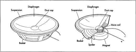

Well, a fun one is to use 2 audio speakers and light first-surface mirrors (FSMs) to make an x-y laser pointer deflection system. You need to figure out how to mount one end of the mirror to the center of the dust cap in the speaker and the other end to some sort of hinge mechanism near the edge of the cone (which is fixed with respect to the speaker enclosure). That way, as the speaker cone vibrates in and out, the FSM rotates about that hinge. An even better arrangement is to figure out some mechanical mechanism that attaches to the dust cover and the edge of the speaker, and allows the mirror to rotate like a teeter-totter so that the middle of it is just changing angle and not moving in and out with the speaker cone.
Use a low-power laser pointer to bounce off the center of the two mirrors, and arrange the speakers so that they provide x & y deflection of the beam. Be careful to aim the beam at a safe surface so that there is no chance of anybody getting a strong reflection in their eye. Then drive the two speakers with simple tones or more complex waveforms to see that kind of patterns you can make. You could probably use the stereo output from your cellphone (or two cellphones) with a signal generator App to generate the tones to feed to the (externally powered) speakers.
EDIT/ADD -- You want to place the 2 mirrors as close together as possible, to reduce the position error on the 2nd mirror. Here is the basic construction of most audio speakers for reference:
