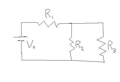

Write an expression for the voltage across R3 in terms of V0, R1, R2, and R3. Under what condition is the voltage across R3 approximately independent of the value of R3?
I uploaded a picture.
I think Req = R1 + R2...
and 1/Req = 1/R1 + 1/R2...
Are what I need.
Best thing I could think of doing was adding R2 and R3, and then add R1 to get this:
1/R2+R3 + R1, but I don't know how to include the voltage.
And I have no idea what it means by what condition is the voltage across R3 approximately independent of the value of R3.

While finding Req first and finding the voltage drop across R3 from there is a valid method (and I suggest you work it out for learning purposes), also consider the application of Kirchoff's Voltage Law

What would happen if R1 << R3 or R2 << R3?

Without R3, you can see R1 and R2 form a potential divider, dividing that potential V0. R3 could represent a load that you wish to connect, to be powered by that smaller potential set by R1 and R2 and the voltage source.
As you know, the fact of connecting R3 will change the potential divider so the equation for the voltage across R2 must now involve a modification to include the value of R3.
If we denote the voltage across R2 as Vx, then your first task is to start with the basic potential divider equation:
Vx = R2/(R1+R2).V0
and modify it to include R3, since R3 appears in parallel with R2. (At this stage, you have made no simplifying assumptions or approximations.)
