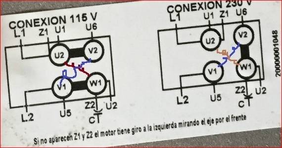

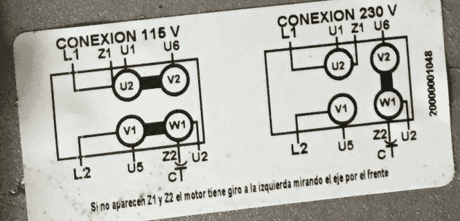

Don't know if it helps but translation is:
If z1and z2 do not appear, the engine is turning left facing the axle from the front.
Likes jim hardy
Obviously the main windings are connected like this
don't know where the other end of capacitor goes
and whether z1 z2 is a start winding

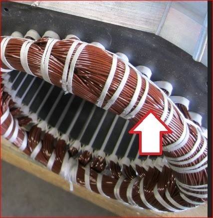

if a winding is burnt up it'll be dark brown or black instead of copper colored
Look closely

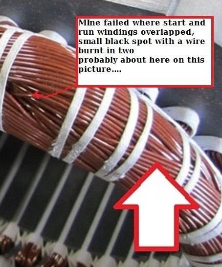

if you're lucky you will find a small black spot where two adjacent windings touched and welded together.if you do, just pry them apart and soak with varnish. I use polyurethane wood varnish or oil based enamel paint.
Our dishwasher melted a wire completely in two - i was able to unwrap one turn and solder the ends back together, varnish and re-wrap with braided Dacron 50 lb fishing line.. It lasted four more years by which time i had scrounged a replacement motor..
Actually two wires had welded themselves together and the whole start winding was discolored.
I repaired that one spot and liberally varnished all of the start winding that i could reach
as i said it ran for several years thereafter. ..
