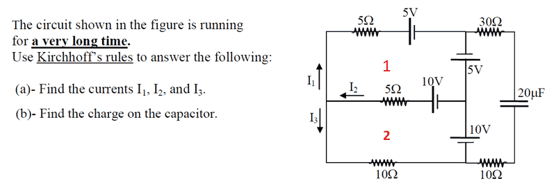

Find the charge on the capacitor and the currents

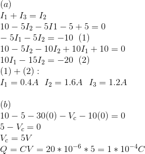

##Q=CΔV##
##V=IR##
C%281%29+%282%29%3A%5C%5CI_1%3D0.4A%5C%3A%5C%3A%5C%3A%20I_2%3D1.6A%5C%3A%5C%3A%5C%3AI_3%3D1.gif
Is my answer correct ?
Yes.
Likes Fatima Hasan
Yes, your results look fine. You should, though, provide more comments in your working to explain what you are doing at each step.
