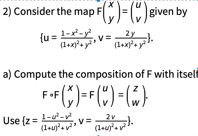

Solution attempt:
$$F(F(x,y))=(z,w)$$
is the map given by
$$x=z$$
$$y=w$$

I observe for x=-1,y=0, u=0/0,v=0/0 not defined so this point should be excluded.

$$y=w$$
No. The map is given if you express ##z=z(u,v)=z(u(x,y),v(x,y))=z(x,y)##. You have to substitute the ##u,v## with their definitions in terms of ##x,y##.

I assume after the substitution he got this result
##F^2=E##
##F=F^{-1}##

Maybe, but I guess there is no way but calculation to be sure. It looks a bit like a local Lie group.
I should appreciate it if you would tell me what kind of transformation this ##F = F^{-1}## is. Named? Usage?
It is called reflection, or involution.

I corrected it. Idempotent functions are ##F^2=F##. We have theoretically ##F^3=F## and any element with ##F^n=F## qualifies to be idempotent, but Wiki said idempotent functions are those with ##n=2##.
So let's call it reflection or involution. These terms already suggest their usage. Any reflection satisfies ##F^2=1:## reflected twice is the original. This is a geometric property but as such also used in physics whenever geometry plays a role (crystallography, particle physics, mechanics). Other examples for involutions are matrix transposition, complex conjugation or the Legendre transformation.

As Fresh_42 was explaining, ##F## is a "Möbius transformation" at its core, an involution about a circle in an offset coordinate system. That's how I got my answer by thinking ##F=F^{-1}##. Although my answer is probably wrong, because ##F## is not defined everywhere on the ##uv## plane to start with. I wonder if the composite map would be different if I computed everything out?

We can construct this transformation as follows. First, we have something simpler: $$u = \frac{2x}{x^2 + y^2}, \ \ v = \frac{2y}{x^2 + y^2}$$ Leads to the same inverse transformation: $$x = \frac{2u}{u^2 + v^2}, \ \ y =\frac{2v}{u^2 + v^2}$$ Now, if we let ##x' = x +1## and ##u' = u +1##, and we let:
$$u' = \frac{2x'}{x'^2 + y^2}, \ \ v = \frac{2y}{x'^2 + y^2}$$ With the same inverse transformation: $$x' = \frac{2u'}{u'^2 + v^2}, \ \ y =\frac{v}{u'^2 + v^2}$$ Then express that in terms of ##x, u## we have:
$$u +1 = \frac{2(x+1)}{(x+1)^2 + y^2}, \ \ v = \frac{2y}{(x+1)^2 + y^2}$$ With, again, the same inverse transformation. Finally, we re-express ##u##:
$$u = \frac{1 - x^2 - y^2}{(x+1)^2 + y^2}$$ And we see that it's the same transformation as above.

Although my answer is probably wrong, because is not defined everywhere on the plane to start with. I wonder if the composite map would be different if I computed everything out?
The transformation for (x,y)=(-1,0) ## u(-1,0)=-1, v(-1,0)=0##, otherwise as above mentioned would be defined for all xy, uv plane.
