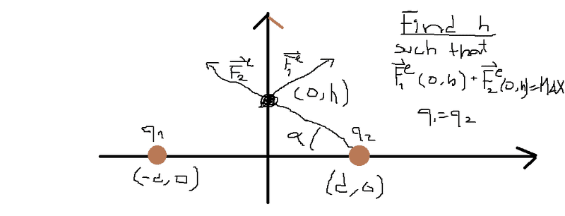

Find the point where the eletrostatic force is maximum. (With drawing)

The net force will be:
[itex]F=\frac{2*Sin(\alpha)*q1*q}{(d/cos(\alpha))^{2}}=cos(\alpha)^{2}*Sin(\alpha)*qq1/d^{2}[/itex]
Taking the rerivative to find the maximum we get:
[itex]\frac{d cos(\alpha)^{2}*Sin(\alpha)}{d\alpha}=0 \Leftrightarrow cos(\alpha)^{2}=2*Sin(\alpha)[/itex]
How do I solve this?
The attachment is broken.
Sorry, here it is:
I do not think the final equation is correct. Show how you differentiated the previous equation.
[itex]\frac{d cos(\alpha)^{2}*Sin(\alpha)}{d\alpha}=0 \Leftrightarrow cos(\alpha)^{2}´*sin(\alpha)+cos(\alpha)^{2}*sin(\alpha)´=0 \Leftrightarrow
-2*sin(\alpha)*cos(\alpha)+cos(\alpha)^{3}=0 \Leftrightarrow cos(\alpha)^{2}=2*Sin(\alpha) [/itex]
-2*sin(\alpha)*cos(\alpha)+cos(\alpha)^{3}[/itex]
This should be ## -2*sin(\alpha)*cos(\alpha)*sin(\alpha)+cos(\alpha)^{3} ##
Thanks, don't know how I missed that!
I assume you can continue from here.
