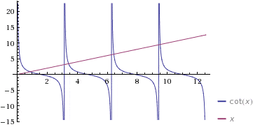

How do I find the first 10 positive solutions numerically?

But here's one hint: One thing I would try is to take the reciprocal of both sides of that equation, giving you:[itex]\displaystyle \cot(x)=x[/itex]
Graph each side.

SammyS said:Here are the graphs of y=x and y=cot(x), superimposed. (from WolframAlpha)

I can make graphs of this with the Tikz package and in Mathematica (that isn't the challenge here). How can I use Mathematica or Matlab to generate the first 10 positive solution?
Thanks. Hopefully in the spring when I take programming in Matlab I will be better at this.Ray Vickson said:I don't have access to Mathematica (except through Wolfram Alpha) or to Matlab, but in Maple it is easy:
S:=fsolve(tan(x)=1/x,x=0..Pi/2),seq(fsolve(tan(x)=1/x,x=Pi/2+(i-1)*Pi..Pi/2+i*Pi),i=1..9);
S := 0.8603335890, 3.425618459, 6.437298179, 9.529334405,
12.64528722, 15.77128487, 18.90240996, 22.03649673,
25.17244633, 28.30964285
I'm sure it must be possible, even easy, to do the same thing in Mathematica.
