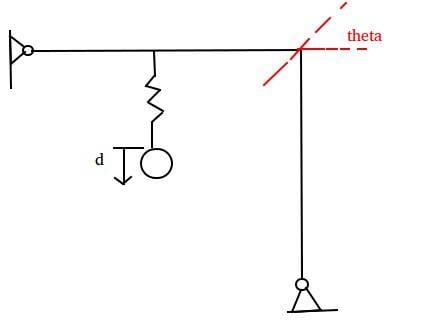

Hi,
This is not an homework. I'm doing a old exam question and have diffuclities. Since there is not a solution I want to get confirmed before I goes further with other similar question.
I have the figure belove.
The problem is here

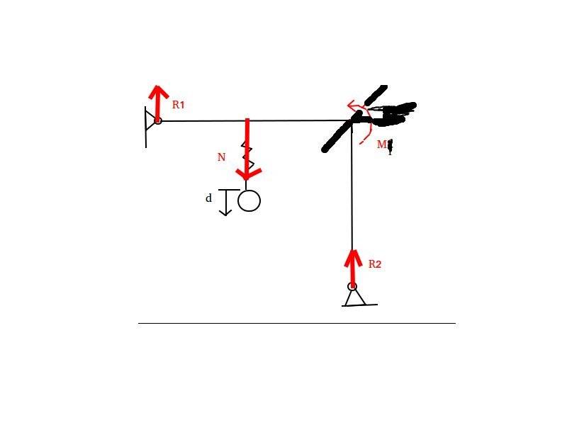

I do like this. Since I should have some bending moment I insert a fictive bending moment which is made by the force N. Then I do draw the forces in different part and solve the system. When I have N then I use the relation N = k.d where K is the stiffness coefficient of the spring. and then I solve for d. Forces R1 and R2 är equal since N is in the middle of the sctructure. But if I insert the fictive force They take other values right? or am I wrong?
I wonder if this is the right wat to do these kind of problem. Please guide me! thanks :)
Your solution is most likely wrong and too simplistic, I think.
Did you apply that prescribed theta and the applied moment or was the part of the initial problem?
I'm assuming that those were NOT part of the initial problem.
I also assume that you were given more information than you are showing: e.x. E, I, L
Pretty sure you can't solve this problem without knowing such things because the structure is statically indeterminate (there could certainly be horizontal reactions at those pins)
Most likely, you are expected to use Castigliano's theorem in the following way:
1) Recognize that your structure is statically indeterminate to degree 1.
2) Change one of the pins to a roller, and replace the missing force with your own force, call it "H."
3) Find all of the moments in the frame as functions of x and y due to "H" and the applied load N (this is possible now since you have made your structure statically determinate).
4) Apply Castigliano's Theorem, which will involve taking the derivative with respect to "H," integrating your moments, etc. (you should know how to do this if you have learned Castigliano's theorem)
5) The motion in direction "H" is actually zero, so you use that constraint to obtain one equation, with one unknown, "H."
6) Since you now know "H," you can use static equilibrium to solve for any other forces of interest..
E.x. 1 at THIS LINK is a statically indeterminate problem of degree 2, if you want to study the procedure.

If you are expected to give a solution in terms of the given angle, then you should do so, in which case you still do my six steps, but instead of "H," you'll have "M." This is sort've what you drew in your original post. However, you ought to split up your structure into two parts: the beam, and the column. Apply the M equal and opposite onto each piece. Go through my steps. Your final solution would be in terms of the angle change.
