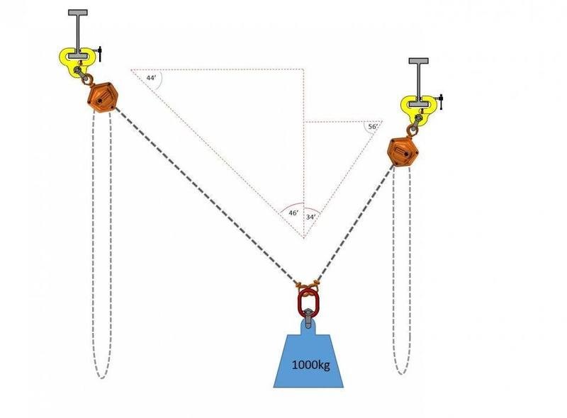

Finding the tension on lifting chains
In summary, Ted is trying to determine the tension in two chains in order to maintain a weight in a particular trajectory.
ted potts
Hi folks, I'm a construction worker helping to destruct an oil platform out in the north sea, I often have to work out weights applied on lifting slings during cross hauling scenarios like the one drawn here, I know 2 ways of working this out already; 1 using a calculation of all the triangles lengths and another by drawing a triangle having one side representing the load ie,1000kg = 10 cm and then drawing the rigging angle side which should represent the tension... however, I'm sure there's a way of calculating this using the angles, cos and sin ... I've had a play but can't get my head round it, can anyone help me with this by explaining the equation please? ps I am not all the best with mathematical symbols so if you could explain it as I would enter it into the calculator id appreciate it, Thanks Ted
Let the tension in the left chain (with the 44, 46 degree angles) be [itex]T_1[/itex] and the tension in the right chain (with the 34, 36 degree angle) be [itex]T_2[/itex].. The horizontal component of force in the left chain is [itex]T_1 cos(44)[/itex] and the vertical component is [itex]T_1 sin(44)[/itex]. Similarly the horizontal component of force in the right chain is [itex]T_2 cos(56)[/itex] and the vertical component is [itex]T_2 sin(56)[/itex]. The total of the vertical components is the weight being lifted, [itex]T_1 sin(44)+ T_2 sin(56)= 1000g[/itex] and, in order that the weight not move left or right, the horizontal components must cancel, [itex]T_1 cos(44)= T_2 cos(56)[/itex]. Solve those two equations for [itex]T_1[/itex] and [itex]T_2[/itex].

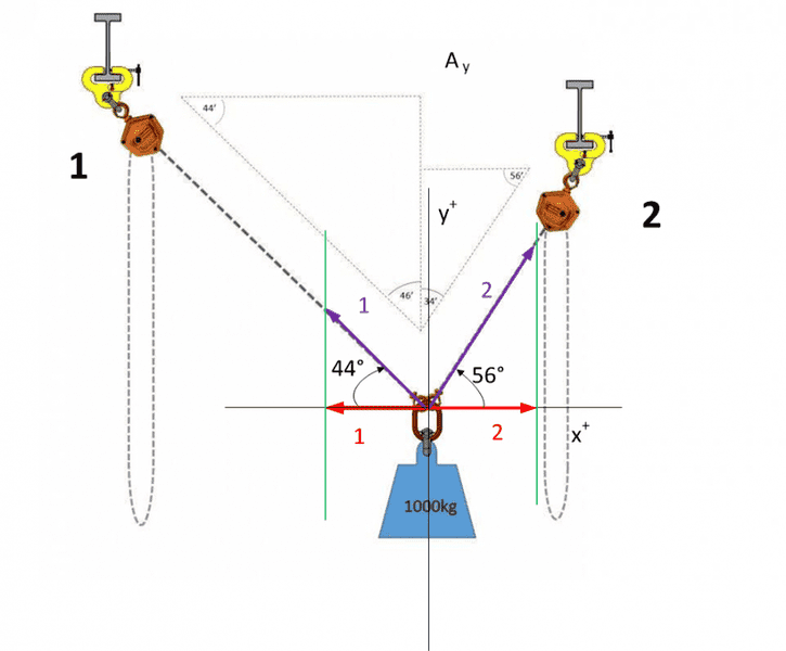

Hello Ted, :welcome:
I feel a heavy responsibility to explain this right and without possibility of misunderstanding ! Wouldn't want to be responsible for your weight dropping into the North sea and even less for denting a hole in a ship or whatever underneath :nb) .
Doing calculations on the static situation is the first stage: you assume load forces are only due to gravity, not to acceleration (i.e. you lift very slowly and smoothly ... ahem..)
And you make use of Newton's law: the load hangs still if the sum of forces on the thing is zero ##\sum\vec F = 0 ##
Therefore you make a so-called free body diagram (or here) of the forces on the load.
Forces in your example are gravity and two sling tensions. Forces are vectors, hence the appearance of these sines and cosines. Vectors have components and the easiest is to look at horizontal and vertical components. Since gravity is vertical, the only horizontal components are from the two sling tensions. So if the sum of horizontal forces has to be zero, these two slings have to pull equally hard in opposite directions in the horizontal plane. In words: red 1 = red 2. In your picture:
And in a formula : $$ \begin {equation} T_1 \cos(44^\circ) = T_2 \cos (56^\circ) \label {eq:F_hor} \end {equation} $$
In the vertical direction the two slings pull upwards and gravity pulls down. Together the two slings' vertical components have to compensate the weight. In words: blue 1 + blue 2 = 1000 kg * g. In your picture:
and in a formula: $$ \begin {equation} T_1 \sin(44^\circ) + T_2 \sin (56^\circ) = 1000 {\rm \ kg\;} \times g\label {eq:F_vert} \end {equation} $$

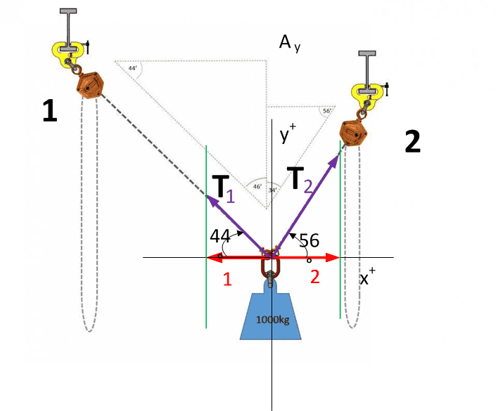

OK, back to business: we had (and I'm glad to have found Ivy come up with the same):
$$\begin {equation} T_1 \cos(44^\circ) = T_2 \cos (56^\circ) \label {eq:F_hor2} \end {equation}$$ $$\begin {equation} T_1 \sin(44^\circ) + T_2 \sin (56^\circ) = 1000 {\rm \ kg\;} \times g\label {eq:F_vrt2} \end {equation}$$ and we are ready to develop a solution algorithm. I don't know the particulars of you calculator, so I'm afraid some further translation step may be needed later on...
From ##\eqref {eq:F_hor2}## :$$\begin {equation} T_2 = T_1 \; { \cos(44^\circ) \over \cos (56^\circ) } \label {eq:T2} \end {equation}$$ and we rewrite ##\eqref {eq:F_vrt2}## using this ##\eqref {eq:T2}## to get $$
\begin {equation} T_1 \sin(44^\circ) + T_1 \; \cos(44^\circ) \; {\sin (56^\circ) \over \cos (56^\circ) } = 1000 {\rm \ kg\;} \times g\label {eq:T1} \quad \Rightarrow \end {equation} $$ $$
\begin {equation} T_1 = 1000 {\rm \ kg\;} \times g \times { 1\over \sin(44^\circ) + \cos(44^\circ) \tan (56^\circ) } \label {eq:sln} \quad \end {equation}
$$ and T2 follows from ##\eqref {eq:T2}##.
Done :smile: !
