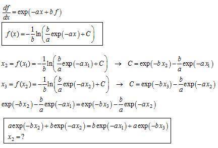

Hi there:
I am trying to solve a two points boundary value problem.
Consider a function f:[x1,x2]->[x2,x3]
x1 and x3 are knowns
x2 is an unknown parameter
f'(x) = exp( -a*x + b*f(x) )
where b>a>0
Two boundaries conditions:
f(x1) = x2
f(x2) = x3
Does anyone know how to solve it?
Thanks!

Consider the equation:
[tex]f'=e^{-ax}e^{bf}[/tex]
now, just separate variables and integrate.

I agree, solving the ODE is rather easy. But the difficulty isn't here.
The boundary conditions raise a very difficult problem:
f(x1)=x2 and f(x2)=x3 with given x1, x3 and unknown x2
In fact, x2 cannot be expressed with a combination of a finit number of usual functions of x1 and x3.
In this case, we need numerical solving in order to compute x2 and then, the unknown constant C which is necessary to fully express f(x).

I do not agree. A second order equation is not needed.
Apparently, there are two boundary conditions f(x1)=x2 and f(x2)=x3. But, in fact, there is only one bondary condition, which is : f(f(x1))=x3 with known x1 and x3. Since x2 is not known, only one relationship f(f(x1))=x3 is remaining.
The ODE f'(x) = exp( -a*x + b*f(x) ) and the boundary condition f(f(x1))=x3, with given a, b, x1, x3 is a complete system, needing nothing more to be fully defined.
So I misread the question, apologies, you basically have a differential equation of the form:
[tex]
e^{-bf(x)}\frac{df}{dx}=e^{-ax}
[/tex]
So to begin with, integrate between [itex]x_{1}[/itex] and [itex]x[/itex] to obtain:
[tex]
e^{-bf(x)}=e^{-bx_{2}}+\frac{b}{a}e^{-ax}-\frac{b}{a}e^{-ax_{1}}
[/tex]
And integrating between [itex]x[/itex] and [itex]x_{2}[/itex] to obtain:
[tex]
e^{-bf(x)}=e^{-bx_{3}}+\frac{b}{a}e^{-ax}-\frac{b}{a}e^{-ax_{2}}
[/tex]
Now from here I see two possible ways forward, you equate that equations and obtain an equation for [itex]x_{2}[/itex] and use Newtons method to find that or you can solve for the unknown term and obtain a implicit expression for [itex]f(x)[/itex] depending on the property of b/a. It's your choice. Do you have numerical values for [itex]x_{1}[/itex],[itex]x_{3}[/itex], a and b?
