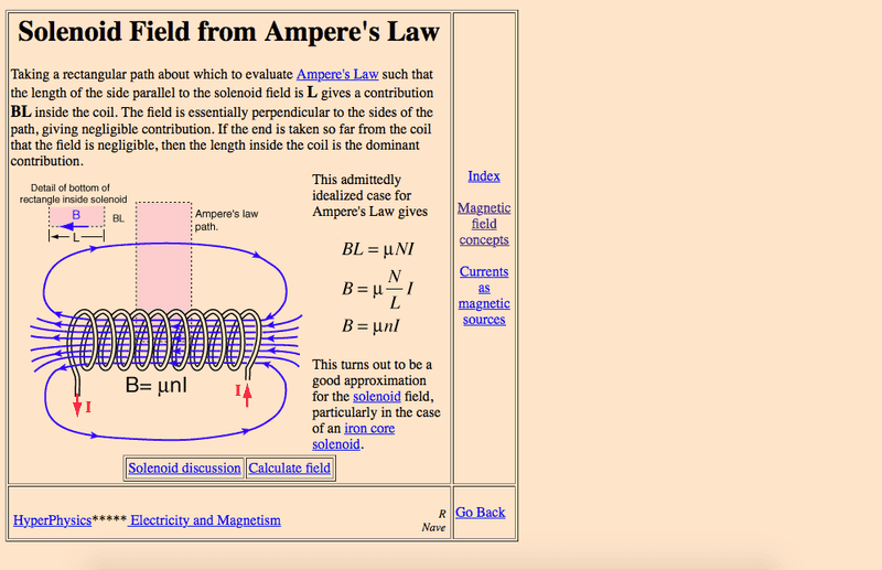

There is some confusion in the above:
"n" is not a number of turns (photo #1). n = dN/dL (windings per length). You can see this substitution in photo #2.

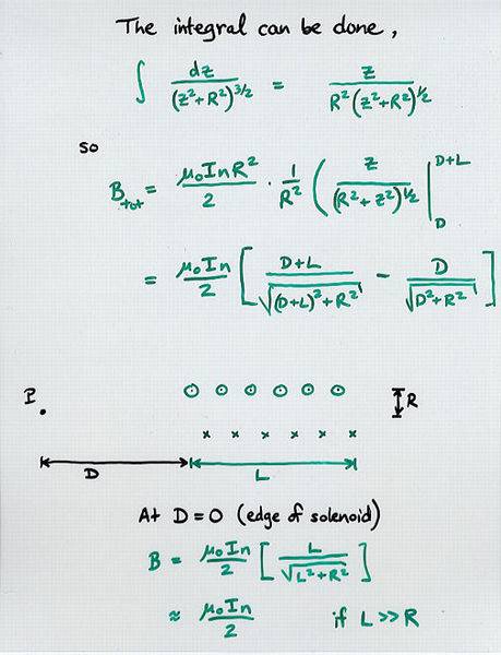

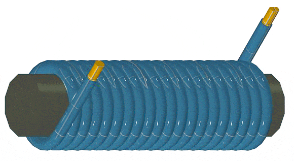

The idea in photo #2 is to choose a very narrow and very high circulation path exactly in the middle of the solenoid, where the magnetic fields must be symmetric.
Here Ampere states that circulationH⋅ds = N * I , and due to the narrow/high circulation path and due to the symmetry, all of the MMF must be induced in the part of the path that follows the x-axis, thus Hx,middle = N * I / L = n * I → Bx,middle = μ * n * I. If you calculate the MMF in a path at the end of the solenoid, some of the accumulated MMF will be induced in the vertical parts of the path, thus the horizontal part of the H-field following the x-axis will be weakened.
In general you cannot use Amperes law to calculate the H- or B-field at some other location than where symmetry rules, because Amperes law speaks of a mean value of the H-field, integrating along a circulation path. Choosing this path asymmetric as to the magnetic field, your calculations will be wrong.
( We are back to Biot-Savart ). I have seen your question in your earlier thread, but I have been busy with other things: ( Crashed my car and my PC-screen broke down ). :sorry:

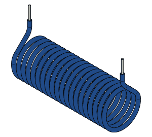

So this is the scenario I am looking to solve. I have a Electric Steel Core, a Coil in the center of it and all other relevant info .
Amperes(i) = 5
Coil Cross Section Radius = 30mm
Coil Length = 100mm
Electric Steel Core Cross Section Radius = 10mm
Electric Steel Core Length = 200mm
Number Of Layers = 4
Number Of Turns Per Layer = 21
Total Number Of Turns = 84
AWG = 5
Diameter = 4.621
Diameter with Insulation = 4.7219
I am looking for the Magnetic Strength in Tesla
1) 5mm away(air permeability) from core(Electric Steel) ending on both sides
2) at Core Ending no both sides .

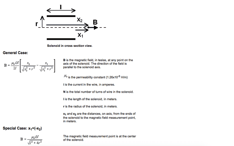

Photo #3,#5: Provide it ?

I have some suggestions as to the answers, combining Amperes law with Biot-Savart.
First of all you draw a circulation path like the one in photo #4, just wider ( larger x ) so that the path crosses the point P.
Using Amperes law you can easily calculate the mean value of H: Hmean1 = ( N * I ) / s , s is the length of the path.
Biot-Savart says, as for vacuum ( boldface means vector ):
dB = ( μ0 * ids x r ) / ( 4π*r3 ) →
dH = ( ids x r ) / ( 4π*r3 )
Of course you should be able to find Hmean1 again by integration of ( H(s)⋅ds ) / s along the exactly same path in vacuum.
Now you insert electric steel ( μr = 4000 ) as core in the solenoid, and the H-field will be disorganized. Anyway just integrate through the path, but when you pass through the steel, you divide H(s) by μr. Call the result of the integration Hmean2.
Of course you will find that Hmean2 ≠ Hmean1. Say that Hmean2 = k * Hmean1 , ( k will be less than 1 ).
But you can make Hmean1 = Hmean2 by dividing all the H(s) ( found by Biot-Savart ) by k. Of special interest is of course H(P).
I think that will work. What do you think ? :smile:

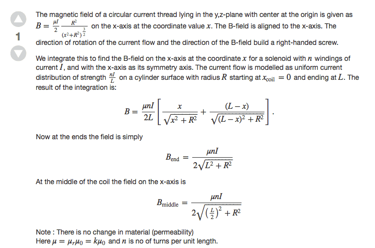

benofer90 said:
can i calculate the solenoid B field at its ending using the formula in Photo #3?
No, because there is only magnetic symmetri at the middle of the coil, which is a precondition of the calculations. In photo #3 you can only calculate Bmiddle. The calculations in #6, using Amperes law, are just used to "adjust" the Biot-Savart calculations.

But hold on. Why are you saying photo #3 gives us only B-middle ?
It clearly states :
B is the magnetic field, in teslas, at any point on the axis of the solenoid. The direction of the field is parallel to the solenoid axis.
x1 and x2 are the distances, on axis, from the ends of the solenoid to the magnetic field measurement point, in meters.
Sorry, I mixed up photos #2 and #3.
But as for #3, the formula is only valid with a constant μ0 ( or constant μ ). When you insert a core with μr = 4000, the μ = μr * μ0 is not constant along the x-axis, and not constant inside/outside the solenoid.
Why is it not constant in the middle or at any point in the solenoid? After all it is a formula of a solenoid (of some kind of core ) If you look at photo #1: (and if you try to use the same data in both photo #1 and #3 you will get the same results for both ending and middle or any point inside the solenoid )
Note : There is no change in material (permeability)
Here μ=μrμ0=kμ0 and n is no of turns per unit length.
Please see link (http://physics.stackexchange.com/questions/95725/magnetic-field-of-a-solenoid-at-the-poles)

Looking at photo #3 again as It clearly states :
then if i have a core μ. the measurement of points x1 and x2 along the axis and with in the core which is longer then the coil winding length then the results would be correct as core is constant. ?
There is no core in any of the photos. Here is a picture of a solenoid with core:
and here without a core:
