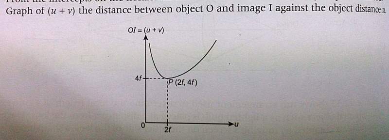

may i know how to derive the the sha[pe of graph and get the point of min (2f , 4f) ? i really have no idea how to get the shape of the graph and the min point. The book give it without any explanation.

Do you have an equation that related u,v, and f?
Put v=d-u, and solve for d.
what equation is that? v=d-u i have only 1/u +1/v =1/f in my book
1/u + 1/v = 1/f is a good place to start - that's the lensmakers formula.
can you rearrange that equation to make v the subject?
v= uf /(u-f) what shall i do next?
OK - so if that is v, then v+u = ?
