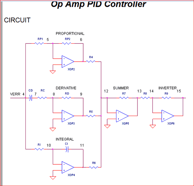

For me, easiest way to keep it straight is to go back to this circuit diagram
http://www.ecircuitcenter.com/Circuits/op_pid/op_pid.htm
Look at bottom opamp, which is the integrator:
R1C1 is Ti , reset time ( or is that RICI? i can't tell if they used number 1 or letter I .)
and over at rightmost amp R9/R8 is gain.

Thanks a lot Jim, I think getting back to OpAmp in this case will give me a better insight. Unfortunately the article is missing the figures. I'll have a look at all this and likely come back with a few questions.

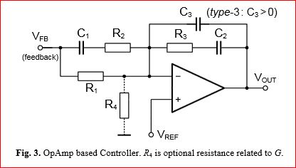

There's a single amplifier implementation dating back to early days of opamps, 1940's
it's derived here in excruciating detail starting at 8:00
i didnt check his algebra , am not sure about his derivative term
but don't know it to be incorrect either

Okay, I went back to the integrator with the OpAmp, and understood your statement. With the OpAmp, RC represents the time it takes the integrator to reach the input value when it's constant (we may consider the difference between the constant input and a 0 value output as the initial error, right?). I thought it was the time it takes the integrator to correct a unity error, but making some calculations it seems that it applies to any magnitude in the input. Please correct me if I'm wrong, I haven't been able to go through all the material, I'm doing it now and through the differentiator to understand the Td. I'll come back with some more questions.
Thanks a lot.
I don't quite grasp that statement. You may have tried to convey the right concept I'm not sure.
