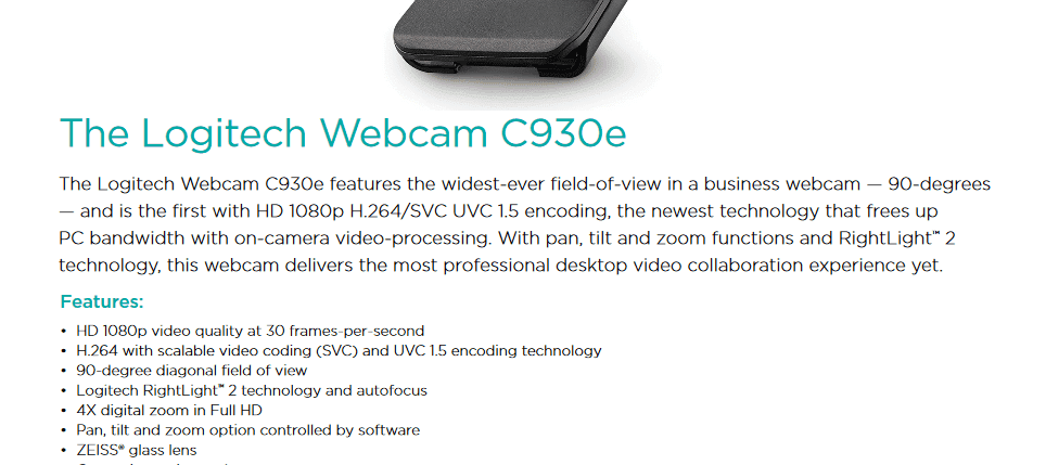

Oh, LOL. No wonder Google couldn't figure it out either. DPI is a printer spec, not a camera spec. Just look for the resolution spec for your webcam. It will be ___ x ___ (fill in the number of pixels in x and y). :smile:
For example, look up HD 1080p from this webcam datasheet...

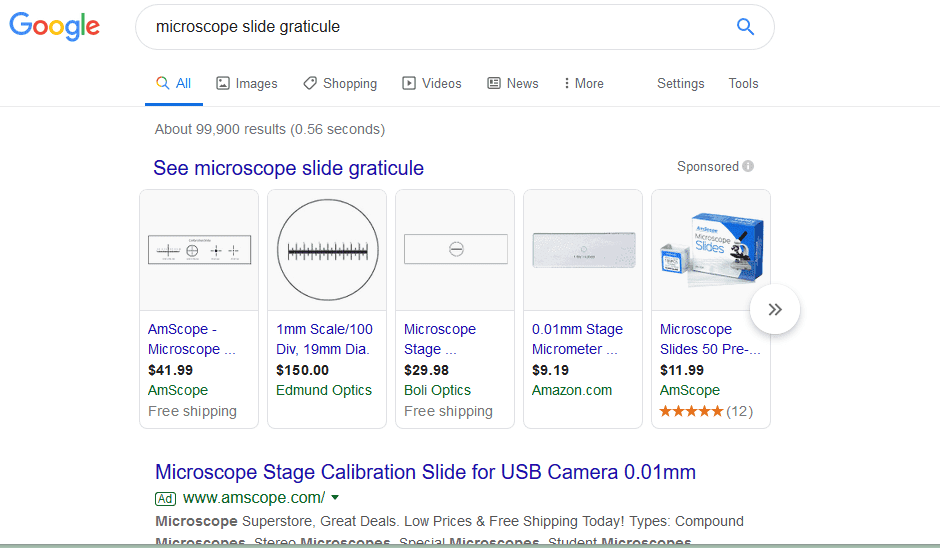

Also, another option would be to get some slides for your microscope that have graticules on them. You can image the slide first, and then put your object under the microscope at the same magnification and image it. That will give you a ruler to measure your object by.
Like these:
Yep. That is exactly what I do for wood micrographs with both my camera (up to 12X) and a cheap microscope (up to about 400X). You can see some of the results on my profile page
