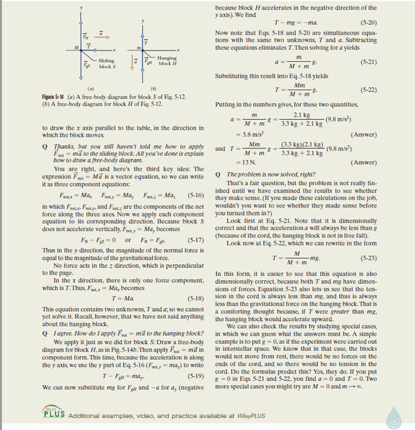

No I am not trying to solve that problem. But I am asking you to clear my doubts on vector and scalar form of any eqn in a general sense. First that needs to be solved and then I will come back to the original problem in OP.
Principles of Physics International student edition.
  • #44
rudransh verma said:
Let’s keep the sign convention constant. I always take +ve as up and right as +ve.
The problem arised I think because in Resnik the free body diagrams and fig. have vectors indicated. And then they write some thing like -mg+F_N=m(0). So I thought they are vectors.
Can you post the figure you are talking about in the book by Resnick Halliday?
  • #46
What's the doubt you have about the free body diagrams you posted?
  • #47
See in FBD they are showing vectors but when solving they are writing like T-mg=-ma.
  • #48
The equations are for the components of those vectors. (Vectors themselves aren't positive or negative, they just point in some direction.)
Likes vcsharp2003
