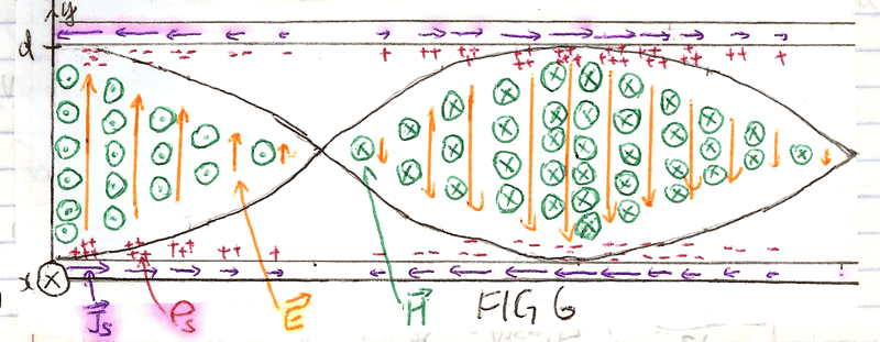

Read my post #5 again. The reason why you see current and voltage is because of the interaction between the EM wave inside the dielectric ( the material between the two conductors) and the surface of the metal conductor. This is called BOUNDARY CONDITION in electromagnetics. This is a very very import concept that you need to realize, but as I said, don't need to think about everyday when you design circuits.
Without getting into the detail, when EM wave hit the metal surface while traveling down the two conductors, surface current and charges developed on the surface of the conductors, that's the physical current you are measuring. As EM wave travel at almost the speed of light, the current also seems like it is traveling at almost the speed of light.
Here is a drawing of TEM wave travel down a parallel plate transmission line that I drew using a diagram from the book Field and Wave Electromagnetics by David K Cheng. Obviously, it is a cosine wave where max is at z=0 and propagate from left to right.
1) The EM wave is travel from left to right.
2) Electric E field is in orange color as arrow indicates. The longer the arrow, the stronger the field. The strength vary as a cosine wave in the diagram.
3) Magnetic field H is going in and out of the page in green color where the circle with a DOT is coming straight out of the page towards you, circle with a CROSS is going into the page. The stronger the field, the more circles there are along the direction of propagation as shown.
4)Surface current Js is in purple and the direction as indicated by the arrow inside the top and bottom conductor plate. The higher the current, the longer the arrow. Notice the arrow change direction depend on the polarity of the wave? That's AC current!
5) Surface charge is in + or - in red on the surface of the top and bottom plates. The higher the charge density, the more + or - are drawn.
If you look at any point along the line on z direction, the EM wave moving at almost the speed of light, so one incident, the wave is at it's peak, a moment later, it's at 0 point. The surface current change accordingly, so if you measure the voltage at one fixed point, you see the change in the E field which give the voltage where V=d*E in this case. d is the separation between the bottom and the top plate as shown in the diagram. So when you measure the voltage at any point down the line, it is as if the voltage and current are traveling at close to light speed. We don't talk electricity, we only worry about current and voltage.
If you want to look into this deeper, read the BOUNDARY CONDITION of EM wave, that's where all the magic happens. This is not easy to understand, but since you kept asking, there is really no easy way to explain this. Again, read post #5 again, just keep in mind this is the mechanics, don't worry too much until the time comes when you learn EM.

Thanks for explaining, I'll keep on finding out more about it until I understand it, but there was a lot of good info in that post, that diagram says a lot too, I can't find a better one on the web, thanks a lot :).

yungman: that diagram is brilliant

So the electric field causes a lot more current than the magnetic field in this picture? What if the electric and magnetic fields swapped places? So do the purple arrows represent the velocity of the current? V=d*E, V is the voltage between what points? "E" is the strength of the electric field where? Thanks, I'm understanding more and more of it.
