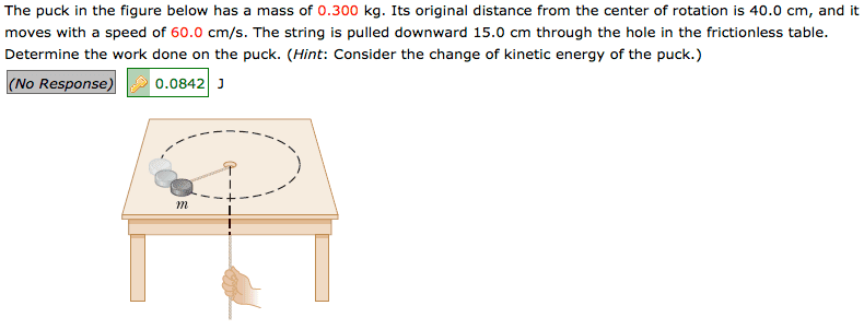

Determining the work done on the puck using conservation of angular momentum?? Help!
This is what I did...
1) Given
mpuck = 0.300 kg
rinitial = 0.4 m
vinitial = 0.6 m/s
mpuck = 0.300 kg
rfinal = 0.15 m
vfinal = ____ m/s
ƩW = KEfinal - KEinitial
2) KEinitial = (1/2)mv2
KEinitial = (1/2)(0.300)(0.62)
KEinitial = 0.054 J
3) KEinitial = (1/2)mv2
KEinitial = (1/2)(0.300)v2
KEinitial = 0.15v2
4) Find v - Angular momentum is conserved due to a lack of friction. The puck goes from 40 cm to 15 cm, so it has a different angular momentum.
Linitial = Lfinal
initial = Iωfinal
[STRIKE](0.300)[/STRIKE](0.4)(0.6)2 = [STRIKE](0.300)[/STRIKE](0.15)v2
(0.4)(0.6)2 = (0.15)v2
0.144/0.15 = v2
0.96 = v2
0.979 = v
5) Plug v back into Net work equation
ƩW = (0.979) - (0.054)
ƩW = 0.925 J
Which is wrong...
Help!
riseofphoenix said:
Linitial = Lfinal
initial = Iωfinal
You want those squares?
Oh...
But even without them I still get the wrong answer.
(0.4)(0.6) = (0.15)vfinal
1.6 = vfinal
4) KEfinal = 0.15(1.62)
KEfinal = 0.15(2.56)
KEfinal = 0.384
So,
W = (0.384) - (0.054) = 0.33
Still wrong...
brb in an hour!
Is 0.15 m correct for the final radius? Another reading of the question might help.
Final radius would be... .4 m - .15 = .25!
Ohhhhh thank you!
