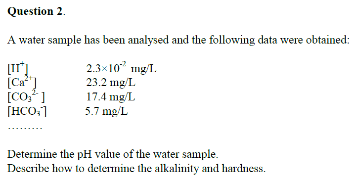

I have no idea how to solve this. Any info would be helpful.

OK, can you use information provided and this equation to calculate pH?
pH = -log [H+]=-log[0.23*10-2]=2.638 ??
No, you need molar concentration, not mg/L.
m=0.0023g
M(H)=1g/mol
n=m/M=0.0023mol
c=n/V=0.0023mol/l ?
Luckeris said:
m=0.0023g
This is not equivalent to 2.3*10-2mg, but other than that you are on the right track.
Oh yeah mili- means *10-3 not *10-1
m=2.3*10-5g
M(H)=1g/mol
n=m/M=2.3*10-5mol
c=n/V=2.3*10-5mol/l
pH = -log [H+]=-log[2.3*10-5]=4.638
Is that it in terms of pH?
Yes. Perhaps too many significant figures, but that's correct approach.
Now, look for definitions of both alkalinity and hardness, and think how they apply.
Alkalinity - http://www.ehow.com/how_5328969_calculate-alkalinity-caco.html
Hardness - Water hardness is a measure of the amount of calcium and magnesium salts dissolved in water. There are no health hazards associated with water hardness, however, hard water causes scale, as well as the reduced lathering of soaps. Complexometric titration is one of the best ways of measuring total water hardness. Ca2+ + EDTA4- → CaEDTA2-
Indicator (Eriochrome Black T) should be used to determine the end point of titration. Water hardness is usually reported in terms of mg/L of calcium carbonate which could by found from the mass of titrant used.
Good starting point, compare this with the data you are given.
So I have Ca in mg/L which was found from CaCO3 + EDTA4- → CaEDTA2- + CO32- or not?
Close, but not exact. You don't have solid CaCO3, but dissolved one. While calcium carbonate is weakly soluble, it is not completely insoluble. In fact, there are no completely insoluble salts.
