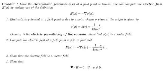

I solved #2,4 but I don't understand what #1,3 need to me. I know that scalar field is a function of points associating scalar value. But how can I prove some function is scalar field or vector field?
That's a good question. What does your textbook say?
Text says scalar is invariant in rotational transformation.Then to prove some functions are scalar field, should I do rotational transformation, or are there any other methods?

A scalar field is a mathematical function that assigns a scalar value (such as temperature or density) to every point in space. A vector field, on the other hand, assigns a vector value (such as velocity or force) to every point in space. In other words, a scalar field has only magnitude while a vector field has both magnitude and direction.
2. How can I tell if a function is a scalar field or vector field?
To determine if a function is a scalar field or vector field, you need to look at the type of output it produces. If the output is a single number (scalar), then it is a scalar field. If the output is a set of numbers with magnitude and direction (vector), then it is a vector field.
3. Can a function be both a scalar field and a vector field?
No, a function cannot be both a scalar field and a vector field. The type of output it produces (scalar or vector) determines its classification. However, a vector field can be derived from a scalar field by taking the gradient of the function.
4. How do you prove that a function is a scalar field?
To prove that a function is a scalar field, you need to show that the output is a single number (scalar) for every point in space. This can be done by evaluating the function at different points and showing that the output is always a single number, regardless of the direction or orientation of the point.
