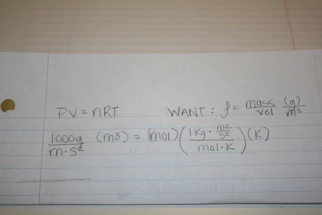

What is the density of radon gas at 0 degrees C and 1 atmosphere?
PV= nRT
0 C = 273 K
density = mass/volume g/m^3
I want density = g/m^3
Below are the units of PV = nRT. I thought that breaking it down would help me to see where the g's and the m^3 are- but so far its just confused me.
I have been trying to manipulate PV = nRT so that the units eventually give me g/m^3. I think I got something close, but then realized that all I have to plug in is T and P. This is what I tried: P/R = nT/V Units end up: g/m^3 = 1/m^3 I'm not sure if that works out...
Nothing is changing so I can't cancel anything and then set up a proportion equation- What the heck do I do??

You won't find the answer with just PV=nRT. This is because mass of the gas molecules has no effect on P, V or T for an ideal gas.
Since density is mass/volume you need to relate mass to volume. What is the number of molecules per unit volume? What is the mass of a molecule of Radon gas?
AM
Thanks so much! I worked it out then referenced to the actual density of radon that I found online and it agrees :wink:
Thanks again AM.
