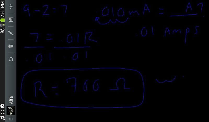

Key word, divide. Supplied voltage: 9V
The L.E.D. is going to "use" 2V of the supplied voltage, so now there's going to be a potential difference of 7V. The relationship between voltage, current, and resistance is as follows, E=IR. So, if the supplied voltage is 7V, then what resistor value do you need in order to get .01 amperes of current (see pic below)?
In understand the above, but I did run into a few hrmmm moments.
A typical 9V puts out around a half of an amp. If this 9V put out 1 amp, would all of this^ still hold true?
We solve for 7V. That makes me want to think the diode is going to see 7V. That's not true...
We say the diode uses 2V, so we subtract it from our supplied voltage. The diode also uses 10mA, yet we don't subtract this figure from the supplied current.
the current capability of the power source is irrelevant
you could have a 9V, 10A power source, it doesn't matter.
The resistor value is still calculated for the voltage drop and the current required to light the LEDOhh and type your maths in as text, that image is very difficult to read
The L.E.D. is going to "use" 2V of the supplied voltage, so now there's going to be a potential difference of 7V. The relationship between voltage, current, and resistance is as follows, E=IR. So, if the supplied voltage is 7V, then what resistor value do you need in order to get .01 amperes of current?
700 Ohms
I do not see how I am solving for the voltage drop across the resistor, so the L.E.D. sees 2V.
The resistor resists current. You reduce current, you reduce voltage, right? I get that. So from that 9V battery, the 700 ohm resistor is going to reduce current down to .01 amps after the resistor. The voltage should now be 2V after the resistor.
I do not see that.
Here, maybe it's best we forget about the diode. If I wire a 700 ohm resistor in series with a 9V, how do I know what the voltage drop is after the resistor?

berkeman said:
V=IR.k
And it's "voltage drop across the resistor", not "voltage drop after the resistor". :smile:
7=.01R
R=700
Nowhere in that equation do I see 2V
7=.01R
R=700
9V - 2V = 7V.
:smile:
So, it's leftover voltage...
Yeah, that's one way to think of it. For the 9V power supply, resistor and LED circuit, you start by looking on the LED datasheet for its forward voltage spec (typically around 2V). Then you decide what current you want to run the LED at (again, look at the datasheet). So then you calculate the resistor value to limit the current to that value while dropping 9V - 2V = 7V across the resistor.
