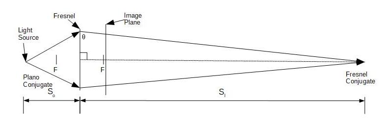

Here is a general diagram of the apparatus. I apologize if I am not clearly explaining it.
I put the 'image plane' a bit off of the focal length so you could see F, but in reality they are at the same location.
Hopefully this can clear up some confusion.
How do you identify the "image plane" in the apparatus?
In terms of the naming, all I am referring to would be the place where the pattern forms for this particular system. In terms of material there is no transmission through the "image plane". If you had an open system for example, you could assume it is a white wall. This would be equivalent to the setup.
The apparatus ends right after this "image plane". It appears this may be a poor nomenclature as you could also consider a theoretical plane at Si as an 'image plane' as well. Refer back to the diagram for Si location. (The typical optics equation for object and image where magnification, locations of these dependent on the other, etc.)
Instead of image plane, let's just assume that a wall is there preventing the light from traveling any further. Would you agree that this is partly why my description is confusing?
And you're sure that is where the image plane is actually located? The only way that this should be true is if the incoming light is parallel, meaning that the source is either located near infinity or there is another optical element in the apparatus.
Drakkith said:
I'm with hutchphd. Why and how does the source produce a pattern in the first place? Is there a simple mask placed just after the light, or is there some other lens integrated into the light source that helps produce the pattern?
If there is no angle to any of the light and there is just a mask, then of course it will always be a larger version of this at any further distance from the source.
This is just a theoretical pattern but one way I can think of is having three separate sources that produce three different parts of the pattern I provided. Let's say three separate LED's are making 3 rectangles, and are in an orientation where at a target distance will be at specific points, and at specific sizes. Maybe one of them you want to be stretched out more so it must be at a specific angle as well.
Of course several lenses could also be used on the light source along with masking of a specific LED. Does this seem feasible?
Lets go back to the the 15' and say that's the target distance. The pattern desired is at this distance, and in my mind an optics engineer reverse engineers the pattern from there probably with software.
From the information I have been given, the image plane is definitely at the focal length. As well as the fresnel information that I have is direct from supplier is given. I can also confirm that there are no other optical elements inside the aparatus.
What you are saying makes sense, but let me ask you this. Wouldn't this be true if the image was supposed to be of the flashlight reflector itself instead of the produced pattern? Like exact size and shape of the reflector?
Wouldn't it make more sense that we are cutting off the projection of this light off at a certain point?
The only thing is the fresnel lens somehow forms the pattern much faster in 4 feet rather than the 15 feet needed normally to form.
This reasoning behind this faster formation is the key bit of information I am after.

Well I definitely see your point. I will answer these with what I can.
Tom.G said:
  1. Take that Fresnel lens outdoors in the direct Sun. Focus the image of the Sun on a concrete sidewalk. Measure and report the distance from the lens to the focused image. That is the focal length of the lens. Use the sidewalk or something else that will not burn, the temperature at the image can easily reach a few thousand degrees.
Focal length 20". I can also confirm that the 'image plane' is located at 20" away from the fresnel.
Tom.G said:
  1. What are the dimensions of the lens?
20" diameter
Tom.G said:
  1. In the device, what is the distance between the lens and the 'Thing' to the left of the lens?
See that is the thing, for experimental research I used a laser that uses an optical element that splits the laser into a dot matrix. The dot matrix was 4" wide and tall after passing through the fresnel lens. Both at 2" and 20" from the fresnel lens, the matrix was still 4" in size.
This becomes no longer true if the image plane is no longer at the focal length.
This begs the question: Why does the dot matrix not change size with a change in distance to the fresnel lens? (when the image plane is at a focal length distance away from the fresnel lens)
  • Although interesting this is not the typical use of this device. Typically the 'thing' is 10-20" away from the lens.
  • The same observation was made with this pattern, where the size on the image plane didn't change when the distance from light source to fresnel was varied.

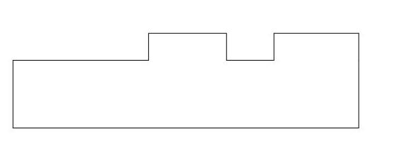

  • 8" wide x 5" long x 5" high. Where the wide dimension is parallel to the fresnel, or in other words where the light source is coming from. The actual size of the light source would be maybe half of these.
  • Not a photograph, nor evenly distributed. There would be some sort of hot spot location within this.
  • They emit a beam of light. Never uniform light in all directions.
  • I am assuming you would mean what someone referred to as a mask, where a shadow would be cast to create a pattern. This is not correct either.
  • Some have multiple sources where they would be doing different things, or creating different shapes to create something like what I showed above.
    • A reflector version could have two reflectors where the beam crosses paths to create a pattern at 15'.

  • 20" is the distance from the fresnel to the plane
  • This is a physical surface for viewing. To make it simpler, we could just consider this a white wall for viewing located at this location.
  • Lets say that at 15' from the wall with no fresnel, this pattern will be 10' wide and fully formed.
    • The pattern size that after passing through the fresnel is unknown. I have yet to be able to use an equation to determine a theoretical size. It is significantly smaller than the size at 10'. Maybe 1/6 the size?

Due to mechanical restraints, a typical lens (non-fresnel) must be used. This particular fresnel lens emulates a condenser. Part of the reason I have came here is because I can't understand why this particular lens is chosen.
The pattern is essential for the entire apparatus, without a good formed pattern the device is useless.
  • Does this somehow condense the light in a way that it forms the pattern faster?
    • How?
  • The formation of this 'good' pattern, is directly tied to the focal length. The image plane being here produces this beam pattern, and no where else is really even close to correct.
The 1/f = 1/u + 1/v formula requires the object distance to be known. The object distance for a laser beam is effectively a long way behind the laser (- ∞) if it's not followed by a lens or other element . If the plane of the focussed image is about F from the lens that would confirm where the 'Virtual Object' lies (All phases relate to the position virtual source of the laser). In your diagram, you label a "light source". Is that the hologram slide? The source is not actually at the hologram if you define 'source' as the place where all paths from a particular point are co-phased. This could account for your confusion.
What does your grid pattern look like at different distances, without the fresnel. Does it get bigger with distance, as if the source is located on your 'hologram' slide?
Did you ever consider using a 'real' object as a light source - like a bulb filament? Try that and get a better idea of the optics.
