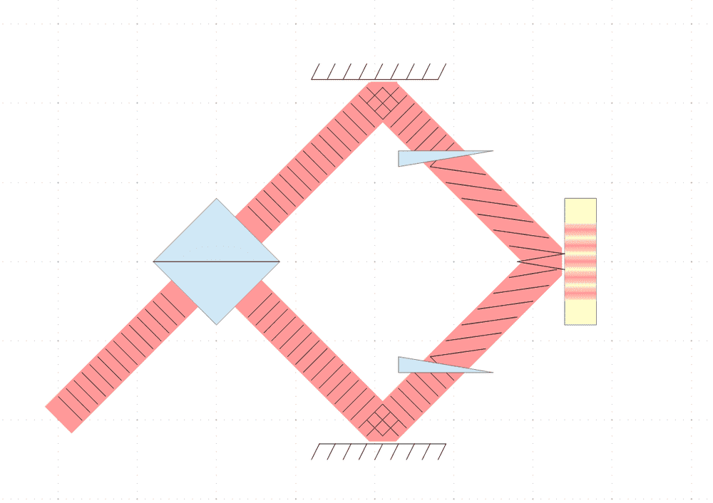

To interfere a wide (fat) laser beam, is it possible to alter the wavefunction so it is not perpendicular to the direction of the beam?

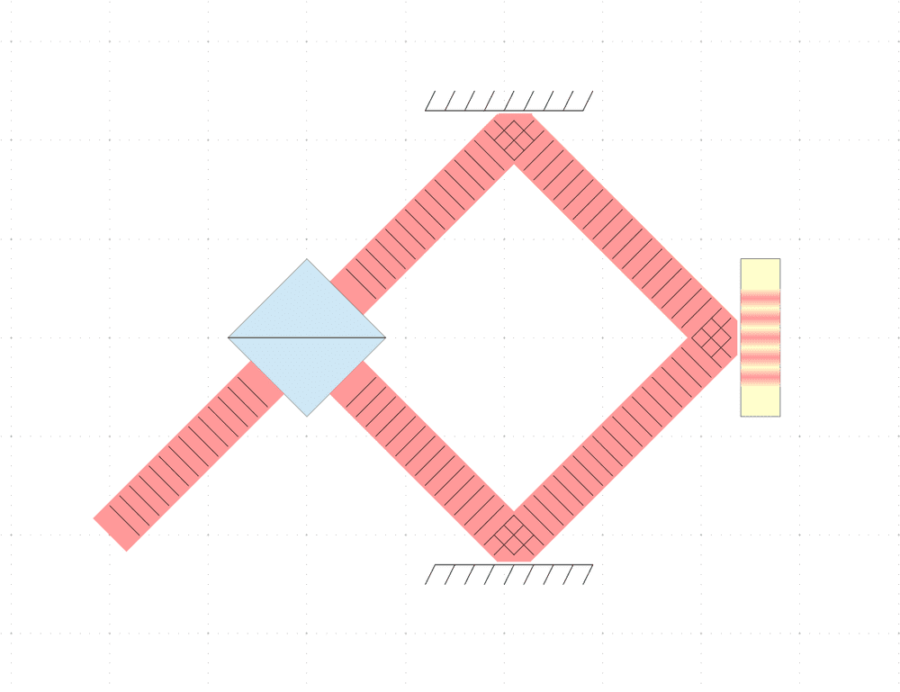

I want to split a fat laser beam and interfere it with itself, kind of like this:
The very obvious problem is that the wave peaks shown as black lines would be a whole lot closer together, so the interference fringes would be sub-microscopic. If a couple of glass wedges - oddly-shaped prisms - were inserted into the two sub-beams, could that cause the wave peaks to be almost horizontal such that the interference fringes were visible? Something like this:
I don't know exactly how the waves behave in glass but can take a stab at it. I would think the entire wave would hit it's peak at the same time, and since the light is going through a medium with a refractive index greater than space or air, parts of the thick beam would be delayed more than others. It would vary linearly across the width of the beam. Tuning the orientation of the glass wedges to get exactly the right angle of the wave peaks would be difficult but not impossible.
A related question is about how to make a beam fat in the first place. Two lenses with different focal lengths can make a beam expnader, but what does that do to the wave peaks? When the beam comes out the second lens, would the waves all be perpendicular to the beam direction as they were before expansion, or would they be curved across its width? If the latter is the case, interfering them again would be painful.
I am talking about the probability density wave, not the electromagnetic wave.
If the wedge idea isn't possible, another idea would be to take, pentagonal prisms - not the right-angle pentaprisms used to reverse images - that are kind of a regular pentagon shape and insert the two sub-beams in two of the consecutive faces such that the come out almost parallel and almost on top of each other, then fully interfere after a short distance. That, of course, has its own problems, specifically in that I can't find such a prism and haven't done the math to make sure it would work - see above questions regarding how to do these calculations.

The prism will cause the beam to change direction. The wavefront must be perpendicular to the direction of propagation.
So this would also have to apply to the case of two lenses expanding a beam - the wavefronts would all be straight lines perpendicular to to beam direction after expansion. The wavefronts would not be some type of curve.
Thank you! I should be able to calculate some things...
If the wave is expanding in the manner of a spherical wave, rather than a parallel beam as you have depicted, then of course we have a spherical wavefront. At each point on the surface, the wave front is perpendicular to the radial direction of propagation.

In the case where there the beam is expanded, first by passing through a lens with a short focal length, crossing at a point and expanding again until it reaches a lens with a long focal length to turn it back into a beam, those wavefront will be, again, straight lines perpendicular to the direction of the beam. The waves would be spherical between the lenses then flat on either side.
Cool, I understand the rule, so now it should be possible to calculate the paths and delays when going through lenses or wedges using kind of a ray tracing.
So to interfere the two sub-beams afer splitting a thick beam, they can go into two side of a prism and merge at the third side. Getting the position and angle correct so they overlap will be not entirely easy.
