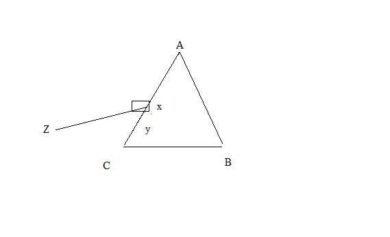

If we could bend the path of the light source with medium (such as water) I wonder if we can still entertain the idea of a closed cycle.
Let the light source, Z, be aimed at a transparent container of water in such a way that it bends and strikes Mirror A. The light then reflects to mirror B, which travels to Mirror C, however we must reflect the light from C in such a way that it passes through the container of water and exits the container in manner that allows the beam to join with the original beam exiting from Z. This could be accomplished by shaping the sides on the container and possibly adding another lens inside the container of water itself. I'm going to see if I can make it work on paper.
The ray path across a change in medium is still a reversible path, so my argument from two posts ago still applies. And we are ignoring the complications of diffraction that happens in a real beam.
