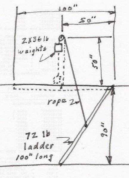

Here's an idea that should work, using one 36 lb weight on a rope over a pulley on each side of the ladder as shown.

Thanks to all so far. The drawing by Insightful represents what I am planning. I reasoned that lifting one the end of the ladder 72 lb (100") would require 36lbs. This seemed to be supported by an answer elsewhere on the forum https://www.physicsforums.com/threads/lifting-one-end-of-a-beam.151526/#post-1214130. What I'd like to know is how to calculate the lbs of lift required when I attach at the midpoint (50") as drawn by Insightful rather than at 100".

As you move the tie point closer to the hinge, the load on the rope increases. Is there a reason that you don't want to attach the rope to the lowest point on the ladder?

Yeah, the size of the hole in the ceiling... about 54"

Well, you calculate it by what's called a "free-body diagram" of the ladder, with x-y forces at the top pin and middle ropes, and just a vertical (y) force at the bottom. Since the ladder as shown in the diagram is almost totally supported by the ropes, the force to lift the bottom off the floor is less than 5 lb.

Thank you... how much downward force is on the ropes supporting the ladder?

The tension in the rope (and hence the force pulling on it) is the weight of the ladder being lifted, plus a component related to the sideways angle off of 90 degrees that the rope is angled to the pull. If you have a long rope pulling it up from a ways away, the total tension/force is very high. There is a large horizontal force needed to generate the small vertical force.
If the rope is at a 90 degree andle to the ladder while pulling, then there is no extra force needed. Hence my initial comment about finding a compromise position for the pulley. Can you post a sketch of the setup? That would help us to show you the FBD that is needed to calculate the best compromise pulley location. :smile:

The tension in each rope is simply the weight added to the end hanging down. In my diagram, that would be 36 lb tension in each rope.
