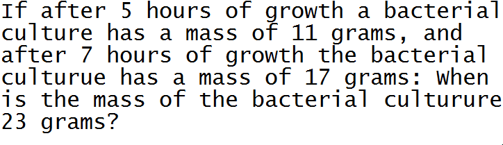

Is this question equals to "after 9 hours"? I'm saying this because with each 2 hours, it's growing by a factor of 6 right? So it should normally be "after 9 hours" that the bacteria would have that mass?! I just want to know if it's right or not. I know of another way to solve it but it gives me a different answer. It this isn't right, I'll use that. Thank you.

No.
Exponential growth isn't linear growth, and that's what you're doing. Thriving populations do not grow at a linear scale.

Thank you. By re-doing it using g=e^rt, I got around 11. I think that about right, right?
"Around 11 hours"? You can be more accurate than that. How many minutes or even seconds?
If your estimate when mistakenly modelling it as linear growth was 9 hours to reach a particular mass, then modelling it as an exponential growth should give an answer less than 9 hours, I'd expect. So an answer of 11 hours sounds way off.
Why don't you show the steps in your working? (Unless maybe you are not wanting to present others in your class with a fully worked answer?)

Now I'm really confused. Redoing it I got 14.04 or something of the sort. Which was done by doing Ln(11)-Ln(17)=Answer. I took the answer and divided it by 2(because of the 2 hour difference). After doing that I took the Ln of 23 and divided it by the answer that I got for Ln(23). I'd made a mistake but I got somewhere around "14.04 hours". I thought that since the mass was increasing so would the time(the "after how many hours").

I got a decimal number. 14.04, which I guess would be 14 hours and 2.4 minutes.

Well that solution is a mess... Too many logical errors to count.
Let's start again from the beginning, shall we? The formula you want to use is
[tex]M=Ae^{rt}[/tex] where M is the mass of bacteria at time t, A is the initial amount of bacteria and r is the growth rate.
We don't know A or r, so we want to find them.
The first piece of info we are given is that after 5 hours, we have 11 grams of bacteria, so we will plug those values into the formula to obtain:
[tex]11 = Ae^{5r}[/tex]
Using the second piece of info, we get
[tex]17 = Ae^{7r}[/tex]
These are two equations in two unknowns, so it's possible to solve for A and r. Can you do this yourself?

Since it took 2 hours to grow 6 grams more from 11 to 17g, it should take less than 2 hours to grow 6g more from 17 to 23g because of exponential growth (it grows faster as time goes on).

I'm at school right now, I've class in a few minutes. But I'm going to print this out and try. Thank you.
