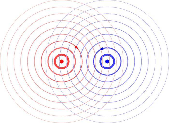

Did you draw the picture? From the given information there are two points that satisfy the given info.
Suggestion, draw the diagram above with the magnetic field vectors at point p from both wires. The magnitudes of the vectors is easy, and you should know the general directions of both vectors, the rest is trig.?
Wouldn't the field be going the same way from both wires? Then what would the x and y look like if the field is just one on top of the other going the same way?
The two vectors will be approximately perpendicular at point p, right? Draw the magnetic field lines that go around each wire and also go through point p from each current, they are circles, right?
The field lines are going to the left on both wires. so I'm confused what direction they would be at point P
The magnetic field from the top wire will be pointing roughly in the 1o'clock direction and the field other wire will point in roughly the 10 o'clock direction?
Angie K. said:
Where did you get the 30 degrees? Careful, this is not a right-angled triangle.
Suggestion: determine the three inner angles first.
Like this but reverse the red arrow.
